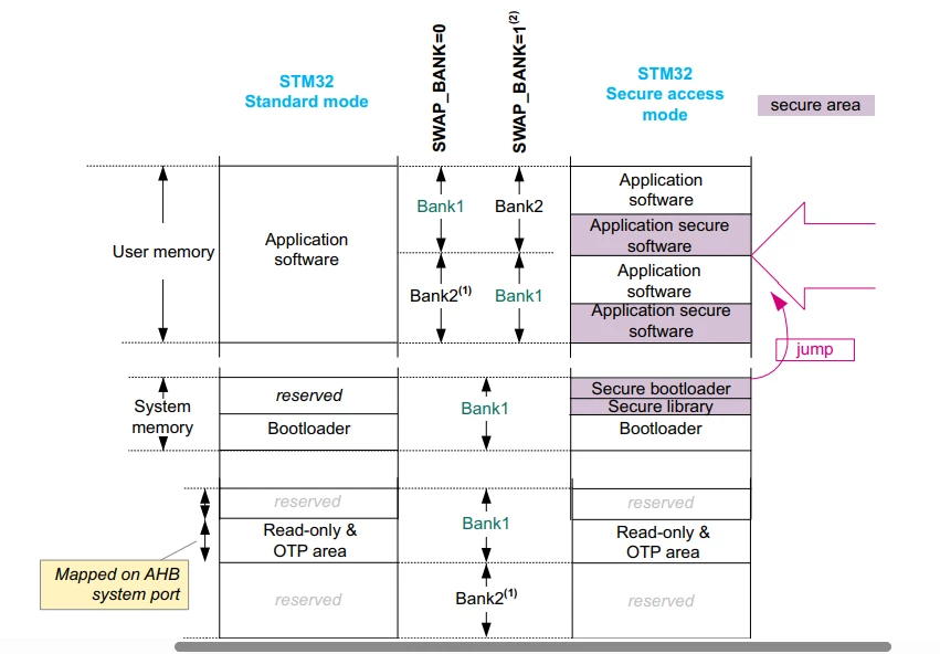

STM32H7 dual flash bank
Hi i am working on a project with STM32H7A3VGT6 chipset which has LTDC controller. my goal is to make a LVGL based UI with SquareLine Studio and interface a 24 bit parallel RGB display with it . so i have made a UI using SquareLine Studio and imported to my project but the issue is when i try to build it it says flash overflowed. i know that the UI takes so much space but the spec of STM32H7.. says it mas  1 MB RAM . later in the linker script i saw it uses dual bank flash not single , so can i use it like this to make it work ? and any one can explain why is the RAM is also divided?
MEMORY
ITCMRAM (xrw) : ORIGIN = 0x00000000, LENGTH = 64K
FLASH (rx) : ORIGIN = 0x08000000, LENGTH = 1024K
/*FLASH2 (rx) : ORIGIN = 0x08100000, LENGTH = 512K*/
DTCMRAM1 (xrw) : ORIGIN = 0x20000000, LENGTH = 64K
DTCMRAM2 (xrw) : ORIGIN = 0x20010000, LENGTH = 64K
RAM (xrw) : ORIGIN = 0x24000000, LENGTH = 1024K
RAM_CD (xrw) : ORIGIN = 0x30000000, LENGTH = 128K
RAM_SRD (xrw) : ORIGIN = 0x38000000, LENGTH = 32K

look at this diagram too

The STM32H7A3VGT6 only has 1 MB of flash memory. You won't be able to use flash memory beyond that.

thats ok can i use both regions into one beacuse my application is too big to fit into one region so thats why i am asking.

Hello @b1aze and welcome to the community.
You can't do that with STM32H7A3VG:
STM32H7A3VG has two banks of 512KB and they are not contiguous:
From AN5293 "Migration guide from STM32F7 Series to STMH74x/75x, STM32H72x/73x and
STMH7A3/7Bx devices" / page 22:

so the issue is my application is too big to fit into one bank  . can i combine both and  make a single bank or single section of  flash so that my application can fit  inside . i need a solution
You can't concatenate both regions in one Flash bank. This was almost said in my previous post.
You need to use another part number having contiguous Flash banks (2MB of Flash size), Ex STM32H7A3xIx:
