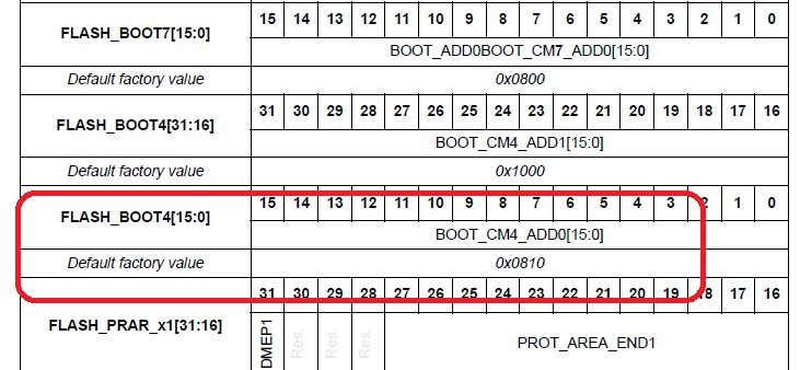

As you said, I only changed the CM4 .ld file. The code 0x081e0000 is loaded to this address. I can verify this with cube programer. I do not change the Option bytes. Default boot address(0x08100000 ). But still CM4 is not working.
mƎALLEm
December 3, 2024
Sorry, this is not the default option byte value for boot address and I think 'e' in 0x081E0000 came from your configuration:
From the RM. The factory value is 0x0810 while you have 0x081e.
