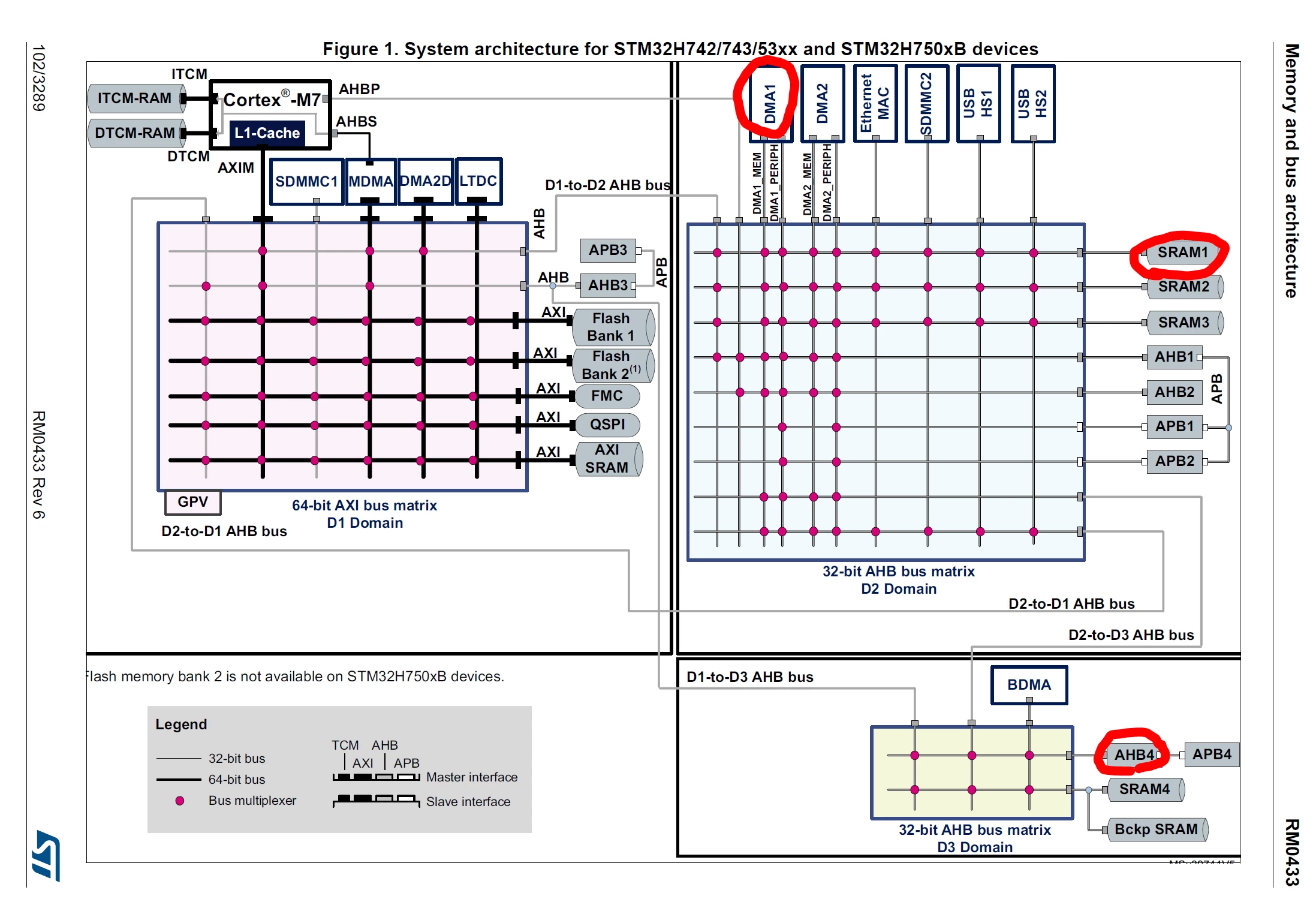

How fast is DMA on STM32H7 mcus? I didnt find any description on how many ticks takes one transaction.
I linked DMA to a timer, transfer from memory to port. With system clock 480 MHz and timer DMA request frequency 40 MHz it doesnt seem to work fast enough. 20 MHz DMA requests works fine...
Memory buffer located in SRAM1, DMA1 is used, D-cache disabled.

I think you might be misreading that table. My reading of it is that e.g. Master Type DMA1 to slave Type APB4 Peripheral has Route=23 and you have to look at footnote 3 to see that Route 23 means 2 = via AHB bus matrix in D2 and 3 = via AHB bus matrix in D3
So it is in clock domains 2 and 3 via the AHB matrix. I guess it might take one clock cycle of the faster clock domain plus two cycles of the slower clock domain worst-case.
Not that it will take 23 cycles!

It depends on many things including where the data is going and how busy the rest of the system is with the relevant buses. Generally, in the tens of MBps, which is consistent with your observations.
Access to GPIO pin registers is generally slower than other things as they're in the D3 domain.

I see. So if want to reduce latency I need to put My memory buffer in SRAM4, and use BDMA instead of DMA1?
November 26, 2021
As far as I understand, yes, that should help considerably. Please report results if you check.

Quick hack on the H723 with a simple Mem-to-Mem transfer from SRAM4 to GPIOB->BSRR, looked to be 10 MHz (5 MHz square wave from pattern buffer)
