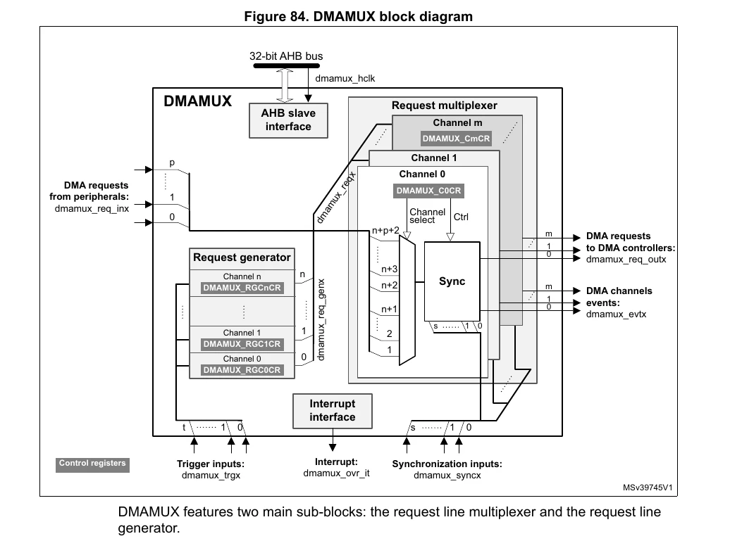

AScha.3
Oct 23, 2025 12:25 PM UTC
which H7 ? (there is more than one...)
If your H7 can...read in rm of it :
-- could use the dmamux , H743 ->
-- in Cube see:
-- or use MDMA :

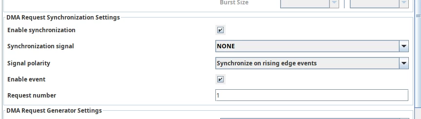

zhaowhongAuthor
Oct 24, 2025 1:33 AM UTC
Hello
What effect does this Setting?
