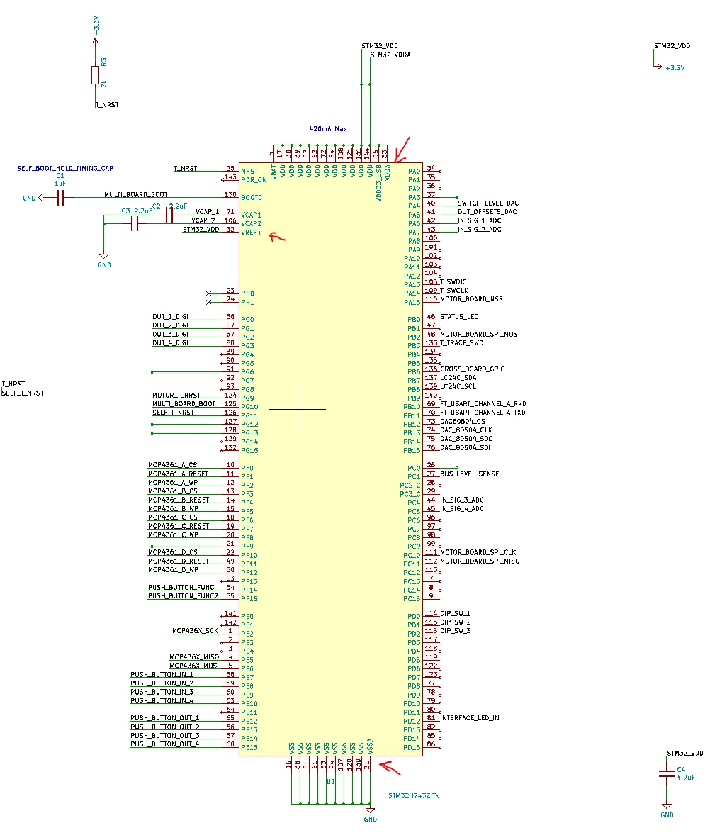

Hello Everyone,
I am using the stm32h7 to sample 4 channels from adc1 using the DMA.
I am using circular mode with half word size. I start the dma and let it fill up a memory buffer:
volatile uint16_t adcInsDMA[4*ADCBLOCKSIZE] = {0};
HAL_StatusTypeDef status = HAL_ADC_Start_DMA(&hadc1, (uint32_t*)&adcInsDMA[0], 4*ADCBLOCKSIZE);
This works, however It looks like I am only getting 6bits of resolution. and not 16.
I consistently get only 63 distinct value no matter when I sample, or what the speed is of the incoming signal etc.
Here are my initialization settings generated by CUBEIDE:

}Any Ideas on what I could be missing would be appreaciated!
Thanks,
Trevor
