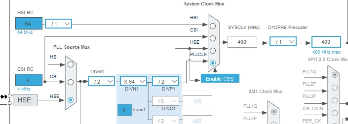

Why the uart stops working on stm32h755 device once the core clock has been modified and code has been generated using cubemx. It comes with a BSP code for serial communication (which i tried seperately) , that is also not working once the core clock has been modified.
by defualt the core clock is in 64Mhz, if i switch the core to HSI with core running at 400Mhz the uart is giving garabage on the terminal in a fresh project.

I didn't reproduce the issue @400Mhz (attached the modified ioc file). "Welcome to STM32 world !" is well displayed.
Are you using the latest version of CubeMx 6.12.0 ?
Check also your cable.

I am using STM32H755 nucleo board
This is working ioc file where i havent touched on the core clock.
