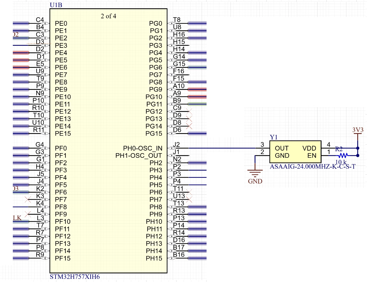

Hi guys,
I been working on this project for some time now on my "free time"...but so far without any success.
In the first prototype I have assembled all the peripherals(QSPI, eMMC, SDRAM, some I2C and SPI slaves peripherals and DSI display.).
Nothing super fancy, with the exception that everything is assembled in a size of a coin ;-D
The power supplies work good. I measured that already.

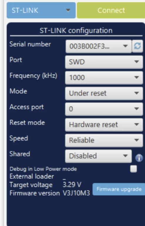

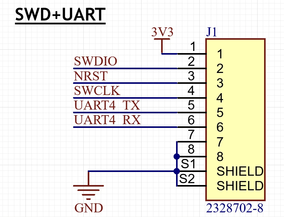

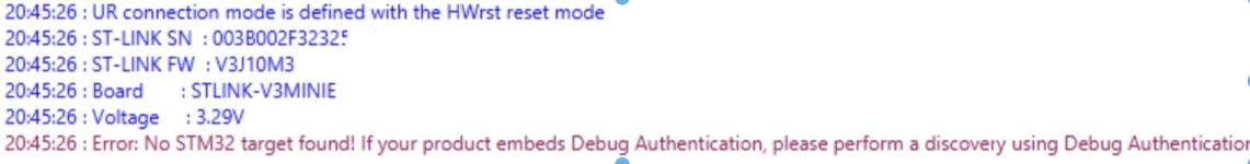

THE issue: The stm32CubeProgrammer can not detect the target MCU over SWD. I have tried all possible modes. Nothing.
THE Dilemma: I am now considering assembling a second prototype with just MCU, power supply, oscillator and SWD connection. In order to out-rule MCU schematic issues. Although this may take some time.

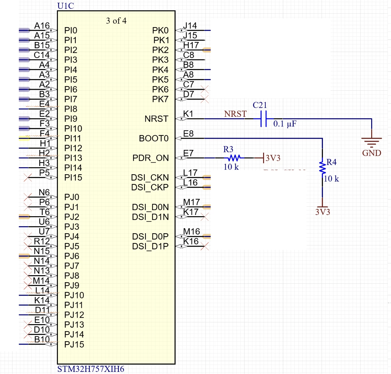

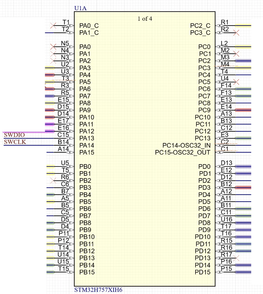

My question to the community is: "Should the SWD interface with the boot configuration work as is ?"
Note: I removed all the peripherals ...just basic MCU connection
This is what I get from STMCubeProgrammer.
I am using a STLINK-V3MINIE as SWD probe.
I would appreciate any tips and comments. Perhaps I have made a super obvious mistake ...but since I am working on this after a 9 hour working day and 5 hours babysiting I am most certainly making a *** mistake :)
Anyway, I would welcome any input or feedback.

Dear @pema ,
As it is a BGA part, may be to perform a quick  soldering inspection to the balls ,  to see is power consumption is abnormal when you hit reset button , Boot0 pin to change to VSS to boot on embedded flash .
Hope it helps ,
STOne-32
pemaAuthor
September 2, 2024
Hi @STOne-32 thanks for the input. I noticed that when I make some pressure on the chip the power consumption spikes. So I am guessing bad soldering.
I will make a new prototype with just a MCU. This way I can step by step rule out the causes of failure.

Try to activate the bootloader and connecting to it with CubeProgrammer via UART (make sure you're using the right pins expected by the bootloader, and connecting TX/RX properly). If that's working, at least you know the chip is alive. If it doesn't, your SWD interface is probably not the issue.

thank you for the links . I will review the design once again, and perform a "just" MCU prototype to make sure the MCU schematic is correct.
Thank you for the UART bootloader tip. I forgot about that one. I could probably even use the USB-FS bootloader ...since I have USB-FS to HS switch integrated.

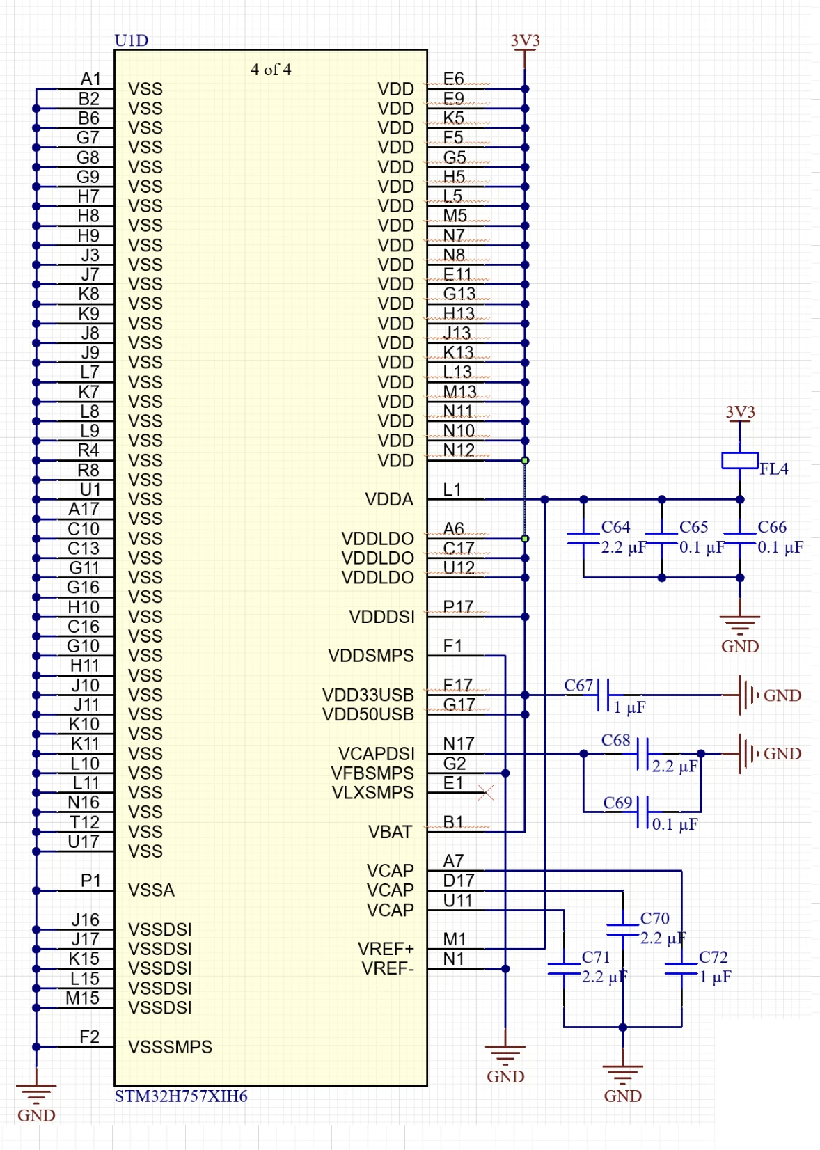

I don't know that H7 - have you checked the power supply wiring, concerning internal LDO / SMPS?
What do you measure at VCAP pins?
Another thing: I always use / see BOOT0 pulled down by default. If pulled up, doesn't it start in bootloader mode? (Which shouldn't worry the ST-Link, I guess)
