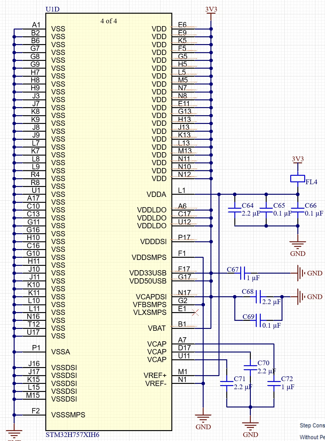

The power input looks like this:

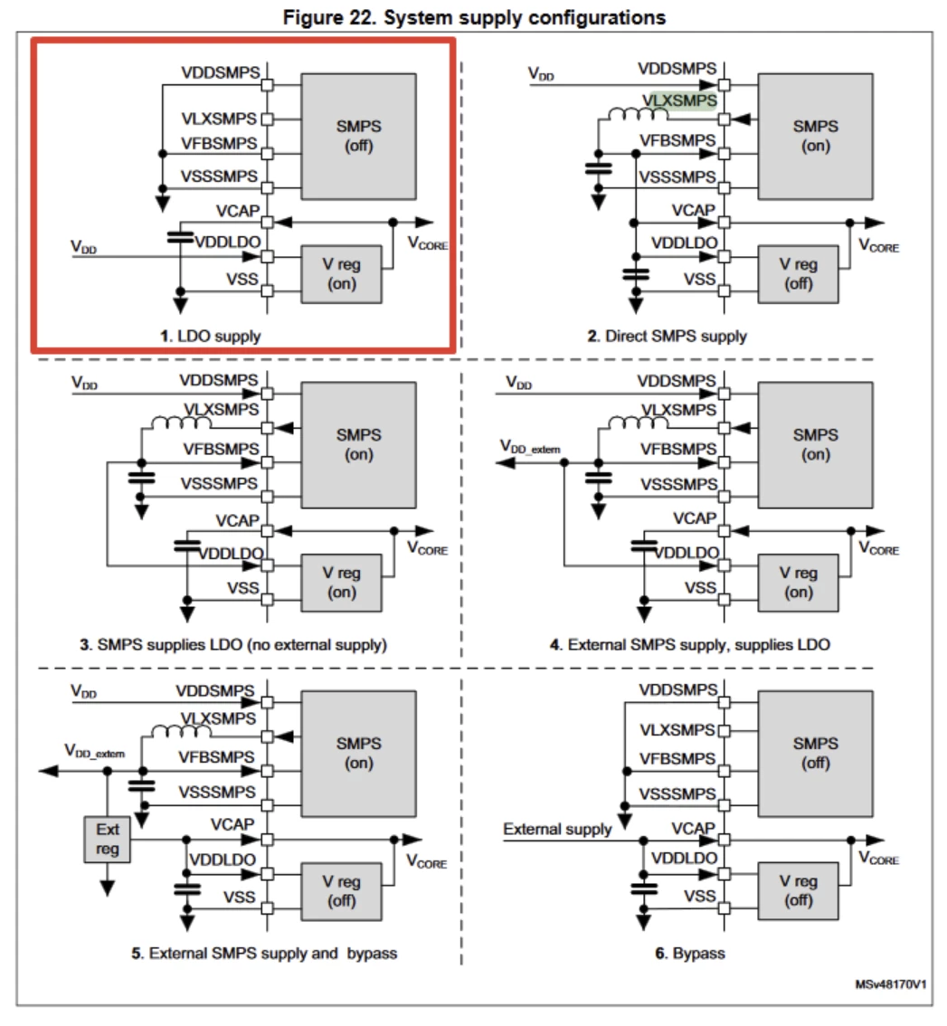

From the System supply configurations I intend to use this one (in red). Being SMPS off and Vreg on.
Am I missing something ?The 3.3V  are stable when I desolder the MCU.

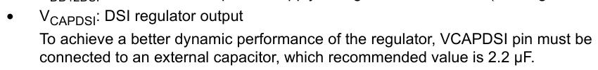

VCAPDSI should not be connected to VDD. It should be bypassed to GND with a 2.2uF cap.
Technically, VCAP pins should be tied together, but unlikely this will cause any issues.

It looks to me: you use a chip with SMPS, but you try to wire like only using LDO.
I am not sure if this works: VDDSMPS and VFBSMSP wired to GND and assuming SMPS is off by default - which I would not take as granted.
Based on my datasheet studies: you have to decide to go with a SMPS chip or an LDO chip. Different pinout on MCU chip!.
Even there is an LDO when you go with SMPS - the LDO is after the SMPS!
So, for a package with SMPS - I wire SMPS correctly (with the inductor). I can enable LDO afterwards, after MCU is running.
So, my five cents: your chip is an SMPS chip, but your SMPS wiring is not correct (where does the figure 22 come from?). Chip starts in SMPS mode (but does not find the external inductor).
If you want to go with LDO only - use a package intended for LDO only.

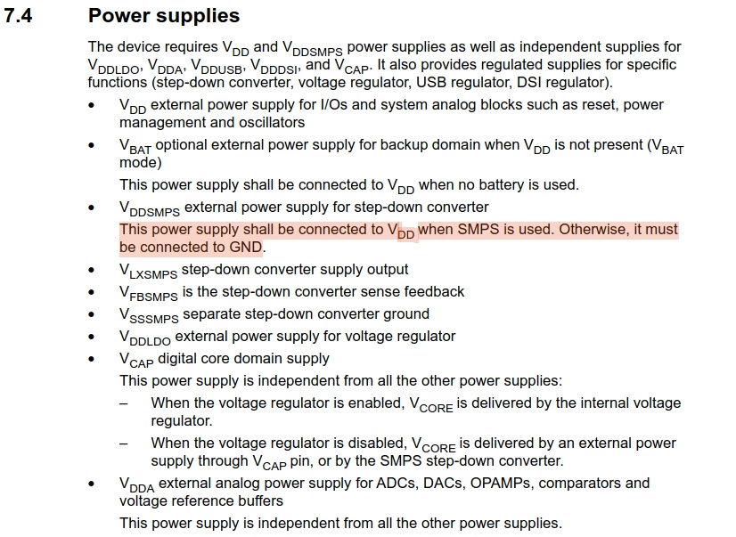

yes you are correct my chip as SMPS and yes I am trying to connect it without the SMPS and just LDO active.
According to the reference manual this should be possible. Yes I should have chose a package without SMPS, but when I started working on this project this was the only package with MIPI-DSI. And I assumed that since the user manual says you can leave it disabled then its okay.
The figure 22 comes from the reference manual page 274/3556 (link below).
https://www.st.com/resource/en/reference_manual/rm0399-stm32h745755-and-stm32h747757-advanced-armbased-32bit-mcus-stmicroelectronics.pdf
Its also found this the. Which confirms what I assumed from the beginning...am I missing any detail ?
