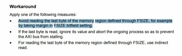

STM32H7 crashes when reading the last bytes from a memory-mapped QSPI
I'm trying to use memory-mapped QSPI with STM32H743XI, but it always crashes when reading the last few bytes (something like 96 bytes before the end address, but not entirely consistent). It crashes without a fault and just disconnects the debugger and has to be reset/power on/off to work again. I tried many things, but I couldn't change anything. I'm aware of the errata "2.4.4 Memory-mapped read of last memory byte fails", but it happens A LOT sooner than the last byte and the behaviour doesn't seem to be consistent with the description there. Also there's no mention for this errata in the revision table and I don't know if my chip is affected or not.
Any help is appreciated :smiling_face_with_smiling_eyes:
