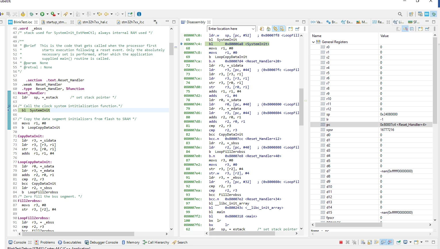

While debugging I noticed that already in the startup file something goes wrong. I try to describe the behavior:
  • Program counter starts in the Reset_Handler
  • Stack pointer is loaded
  • Asm cmd: bl SystemInit (branch to the function SystemInit()) (Picture1)
  • ! Does not jump to the function SystemInit()

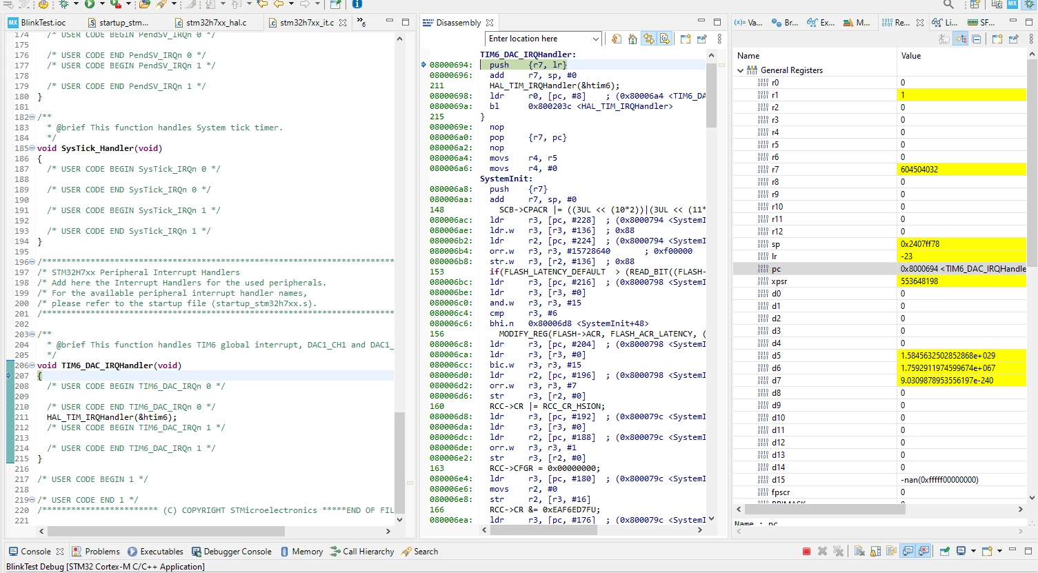

  • ! But jumps into the IQR- Handler of the selected Timbase Source (e.g. SysTick Handler or TIM6_DAC_IRQHandler) (Picture2)
After that the program jumps around in some HAL_ functions and ends up in the Reset_Handler again.
This behavior can be observed on three boards. On the other boards the program counter jumps normally into the SystemInit() function and everything behaves normally. If the SystemInit() function is replaced, the same behavior occurs.

I am attaching two screenshots of the program running. The first picture shows the pc in reset_handler. Sp, lr and pc registers appear normal. If you go a step in debug mode, the pc jumps to a wrong position.

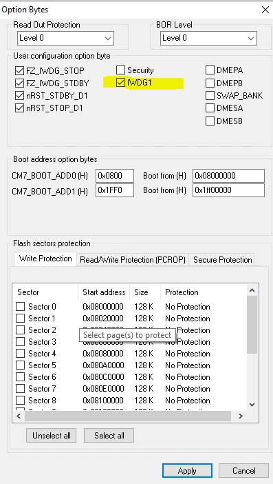

I found the solution. Actually I had the same error as in the description here:
https://community.st.com/s/question/0D53W00000CPohe/stm32h743-iwdg-continuously-reset-mcu
In my Code the IWDG is not activated. But if the hardware control is selected it will get activated automatically.
Somehow the option bytes in ST Link Utility getting modified sometimes. Still do not know exactly why.
Thank you all for your effort!

That's not one single step between the two screenshots, as several registers have changed.
Try single-stepping in disasm and observe what's going on. I don't know how this works in Cube, I don't use Cube.

November 18, 2021
Clearly more has happened between the two screenshots than just a single instruction. One possibility is the watchdog has reset the chip, which would explain the result.
In any case, since the chip has reset and that is part of the behavior you're debugging, read the RCC->CSR register to determine the cause.
Look at the VECTACTIVE bits to determine what interrupt the CPU is in.

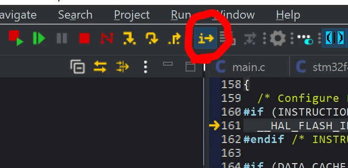

November 18, 2021
"Instruction Stepping Mode" can be enabled with this toggle. When enabled, the "Step Into (F5)" will single step through assembly code. When disabled, it single steps through source code.
