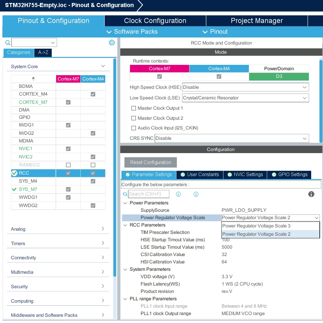

I can't seem to figure out how to get STM32CubeMX to let me select VOS1 for an STM32H755.
I'm using direct SMPS supply. In an older version of CubeMX, I was running VOS0 and 480MHz, but I see that that is not allowed anymore (Have to use LDO for it, which I didn't set up my board for). So I want to run at 400MHz, but CubeMX won't let me select anything but VOS2 or VOS3, which limits me to 300MHz, which doesn't work for me.
Even if I select LDO, though, CubeMX is only presenting VOS2 or VOS3. What am I missing? I know this used to work in an older version...

Hi, I also run into this problem. After I create a empty project for STM32H55, I don't see the VOS0 or VOS1 even though I am using PWR_LDO_SUPPLY and revision V. What am I missing here?

June 6, 2023
Thank you for the reply, it works now. It turns out that even though I select the MCU with 6 suffix when creating project, the generated ioc still has the 3 suffix one.
