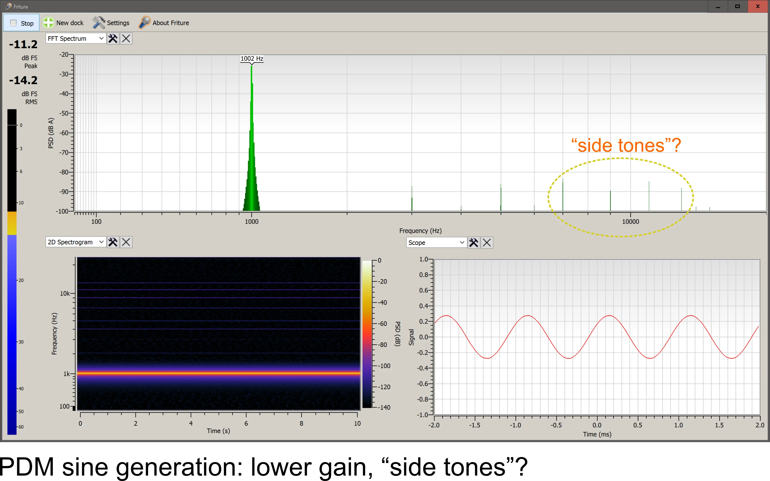

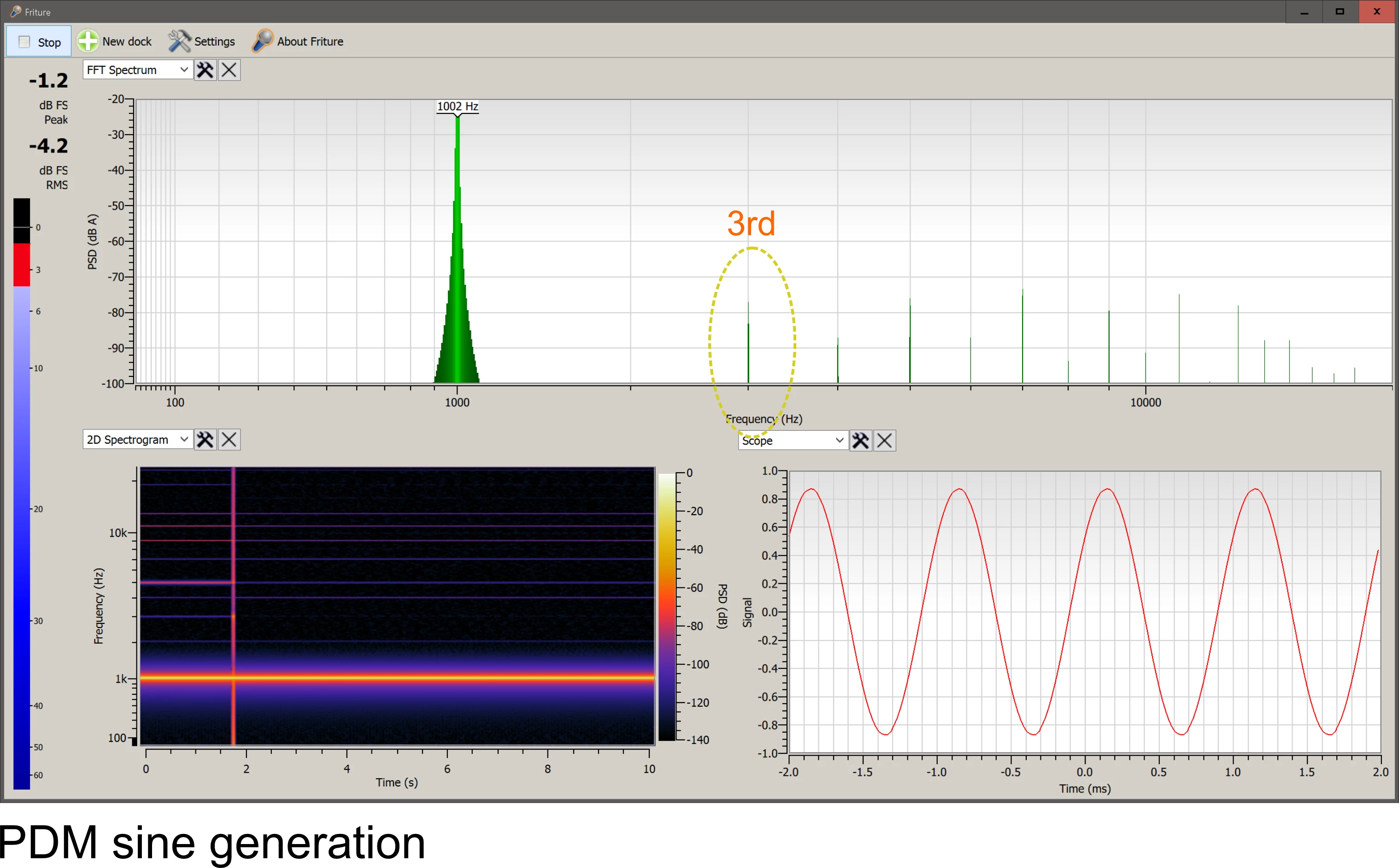

a) the IIR filter:
generates some artefacts (in spectrum, even documented in UM2372, e.g. a remarkable 3rd harmonics). I think to see that also other "side tones" are generated (OK).
The PDM2PCM filter is very sensitive for the right amplification setting (and with which amplitude the signal from PDM comes in). Obvious.

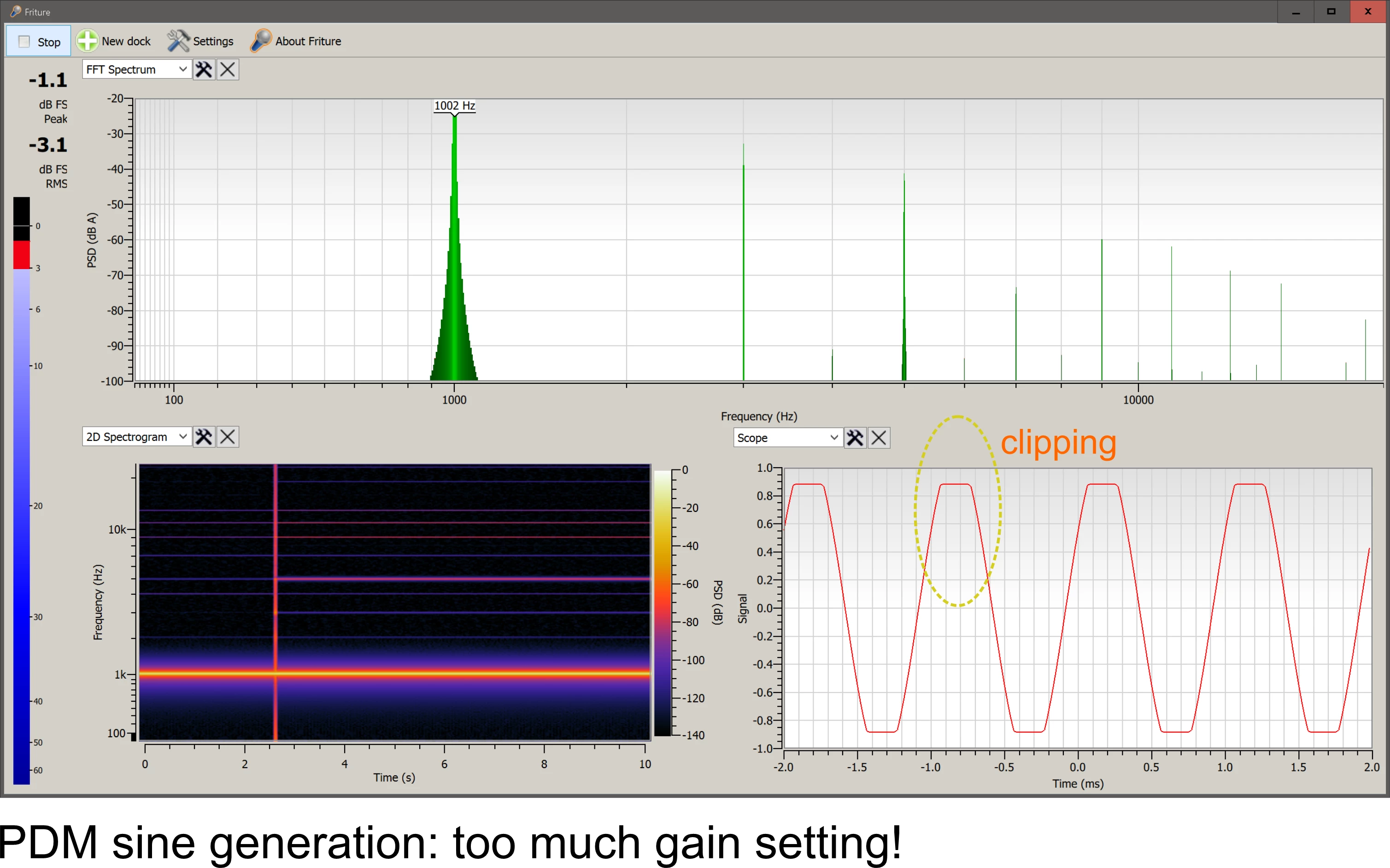

If you do something not really "right", e.g. too much amplification (gain) or a too strong signal, what happens (and I can "see" and hear):
  • the output signal starts clipping (it becomes a "rectangle")
  • and suddenly the filter starts with "self-oscillation": I assume, it starts already to generate "side tones" when it reaches a too high amplitude on output (IIR feeds it back)
All this is acceptable (and obvious), just: "maybe a 'better' " filter design is possible.

Below some examples what I get (from a generated 1KHz PDM sine signal, fed into PDMFilter (not a real MIC signal, no MIC or a speaker involved, a "pure" PDM signal played from buffer - OK, it generates also "side tones").

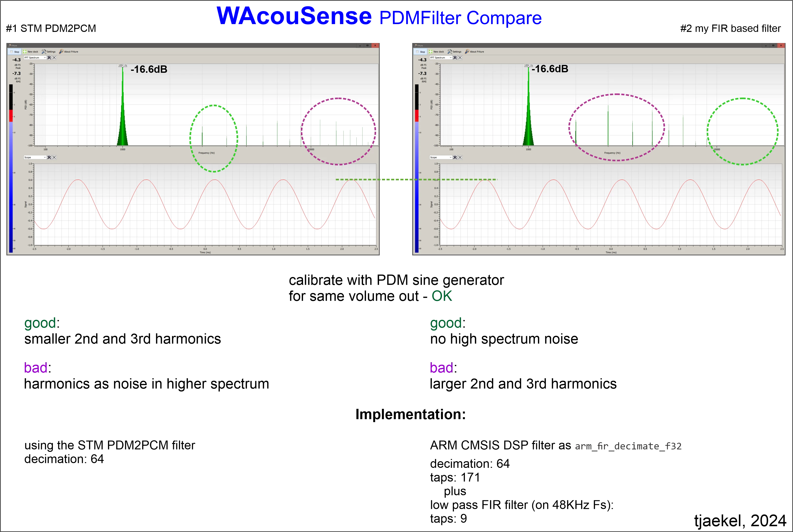

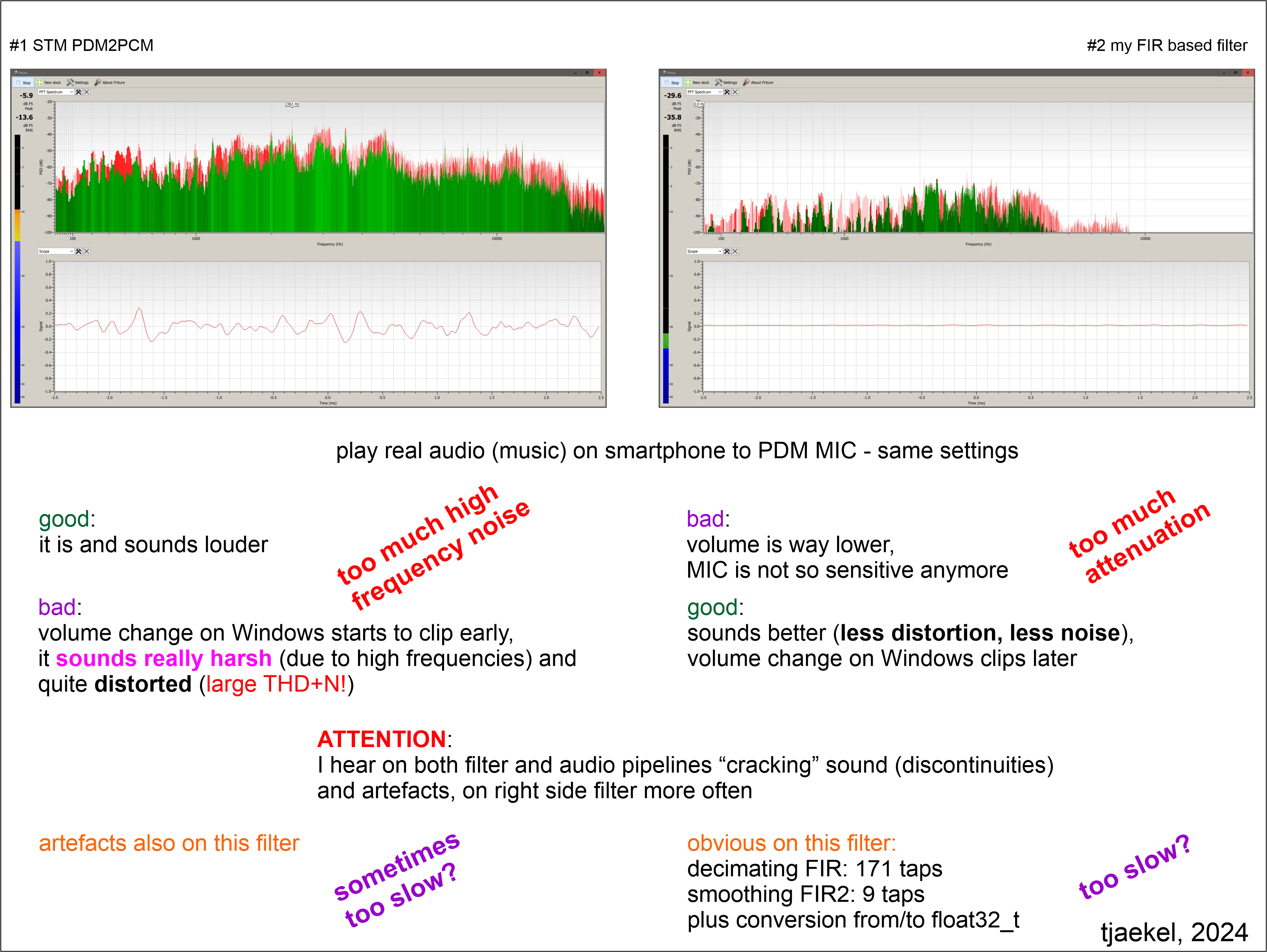

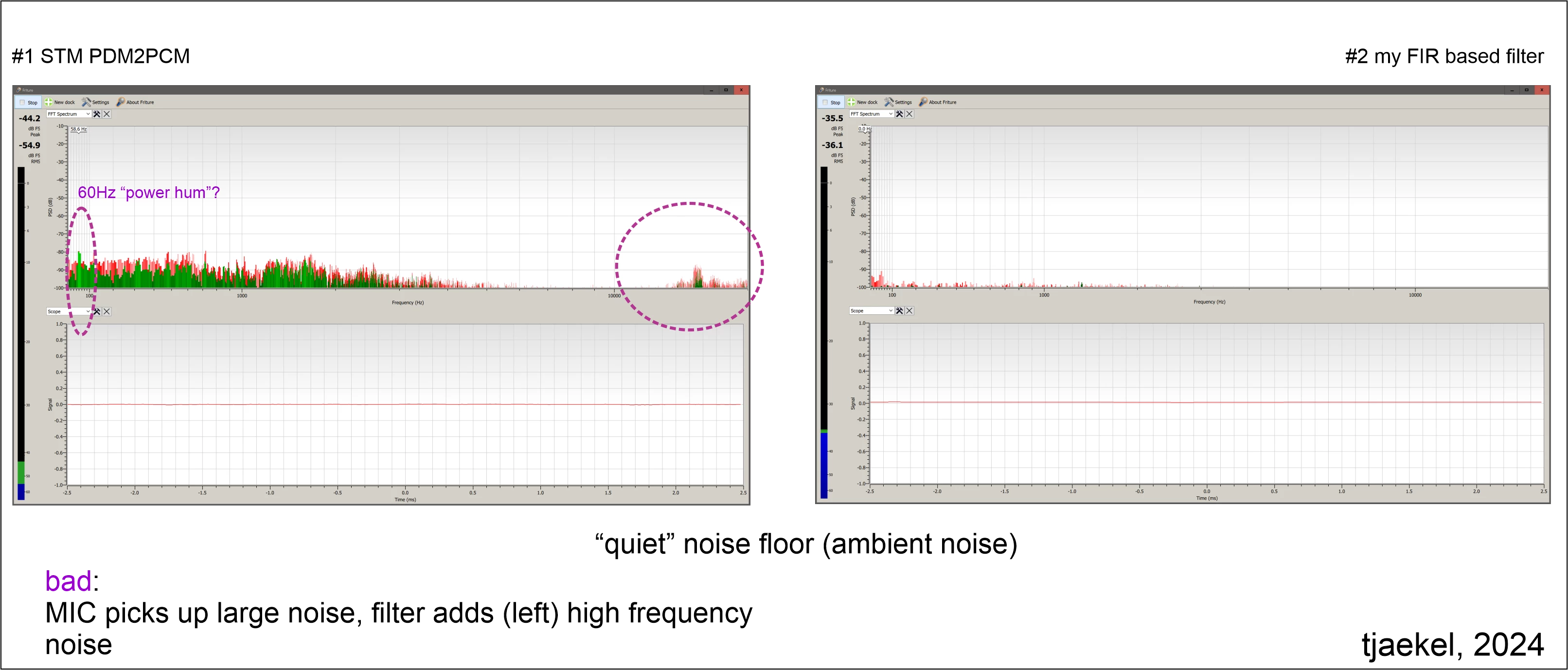

Here some slides comparing the original (latest) STM PDM2PCM filter with my one:
Conclusion:
Actually, the STM PDM2PCM filter is not bad (it has just still too much high frequency noise and distortion due to it). It sounds a bit sharp (harsh).
It might make sense to use this filter (in order to convert from PDM to PCM), but to add another low pass filter (with few taps) afterwards (in order to remove the still remaining high frequency noise).
My project (with my own filter) can be found here:
https://github.com/tjaekel/PortentaH7_WAcouSense
