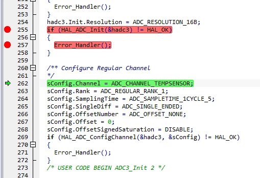

STM32H7 ADC3 setup fails
I am trying to set-up the ADC3 for STM32H7 but the HAL_ADC_Init() fails ?
After debugging, I see that the function LL_ADC_IsInternalRegulatorEnabled() fails in HAL_ADC_Init(). I also see that DEEPPWD is 0 on reset but the datasheet say that it should be 1 on reset. Why is this so ?

I didn't reproduce the behavior on NUCLEO-H743 board.
HAL_ADC_Init(&hadc3) call passed without any error.
Need to check you HW.

MCU is STM32H743.
The code is CubeMx generated.
Clock Config is as given below:

Could you please share your ioc file?
