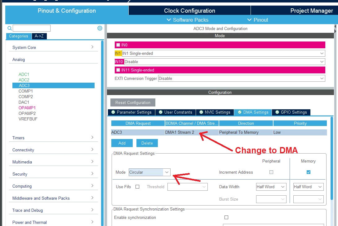

JLope.11
Apr 4, 2024 7:28 AM UTC
Thank you, it worked for me, I used another stream and no problem :)
To make that at the cubeide in the ADC3 you must go to DMA, add and then change in the BDMA to a DMA and stream not used by other ADCs  ADC working-2.png
EStua.1
Oct 8, 2020 2:42 AM UTC
I ran into this issue but i should point out you don't need to use BDMA for ADC3 on some STM32H MCUs - you can use DMA1 stream X instead and avoid this issue all together.
