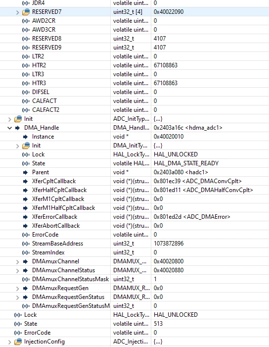

I am trying to use the ADC with DMA but the values on the buffer are not being updated.
Next i detail the steps that i have done:
- Disabled the ICache and DCache.
- Place the DMA buffer in a separate section in RAM_D2 with the address 0x30000000, so there souldnt be problems related to alignment.
- Configure MPU in order to make the previous section not cacheable:
void MPU_Config(void)
MPU_Region_InitTypeDef MPU_InitStruct;
/* Disable the MPU */
HAL_MPU_Disable();
MPU_InitStruct.Enable = MPU_REGION_ENABLE;
MPU_InitStruct.BaseAddress = 0x30000000;
MPU_InitStruct.Size = MPU_REGION_SIZE_128KB;
MPU_InitStruct.AccessPermission = MPU_REGION_FULL_ACCESS;
MPU_InitStruct.IsBufferable = MPU_ACCESS_NOT_BUFFERABLE;
MPU_InitStruct.IsCacheable = MPU_ACCESS_NOT_CACHEABLE;
MPU_InitStruct.IsShareable = MPU_ACCESS_NOT_SHAREABLE;
MPU_InitStruct.Number = MPU_REGION_NUMBER0;
MPU_InitStruct.TypeExtField = MPU_TEX_LEVEL0;
MPU_InitStruct.SubRegionDisable = 0x00;
MPU_InitStruct.DisableExec = MPU_INSTRUCTION_ACCESS_ENABLE;
HAL_MPU_ConfigRegion(&MPU_InitStruct);
/* Enable the MPU */
HAL_MPU_Enable(MPU_PRIVILEGED_DEFAULT);
}- Place all the data sections, apart from the previous one, in RAM_D1.
- Set DMA as circular and memory size as Half Word.
- Enable the DMA and ADC global interruptions.
While running the ADC handler does not show any error, but the buffer remains empty, only updating the first index with trash values.

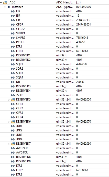

ADC Config:
static void MX_ADC1_Init(void)
/* USER CODE BEGIN ADC1_Init 0 */
/* USER CODE END ADC1_Init 0 */
ADC_MultiModeTypeDef multimode = {0};
ADC_ChannelConfTypeDef sConfig = {0};
/* USER CODE BEGIN ADC1_Init 1 */
/* USER CODE END ADC1_Init 1 */
/** Common config
hadc1.Instance = ADC1;
hadc1.Init.ClockPrescaler = ADC_CLOCK_ASYNC_DIV4;
hadc1.Init.Resolution = ADC_RESOLUTION_16B;
hadc1.Init.ScanConvMode = ADC_SCAN_ENABLE;
hadc1.Init.EOCSelection = ADC_EOC_SEQ_CONV;
hadc1.Init.LowPowerAutoWait = DISABLE;
hadc1.Init.ContinuousConvMode = DISABLE;
hadc1.Init.NbrOfConversion = 3;
hadc1.Init.DiscontinuousConvMode = DISABLE;
hadc1.Init.ExternalTrigConv = ADC_SOFTWARE_START;
hadc1.Init.ExternalTrigConvEdge = ADC_EXTERNALTRIGCONVEDGE_NONE;
hadc1.Init.ConversionDataManagement = ADC_CONVERSIONDATA_DMA_CIRCULAR;
hadc1.Init.Overrun = ADC_OVR_DATA_PRESERVED;
hadc1.Init.LeftBitShift = ADC_LEFTBITSHIFT_NONE;
hadc1.Init.OversamplingMode = DISABLE;
if (HAL_ADC_Init(&hadc1) != HAL_OK)
Error_Handler();
/** Configure the ADC multi-mode
multimode.Mode = ADC_MODE_INDEPENDENT;
if (HAL_ADCEx_MultiModeConfigChannel(&hadc1, &multimode) != HAL_OK)
Error_Handler();
/** Configure Regular Channel
sConfig.Channel = ADC_CHANNEL_16;
sConfig.Rank = ADC_REGULAR_RANK_1;
sConfig.SamplingTime = ADC_SAMPLETIME_32CYCLES_5;
sConfig.SingleDiff = ADC_SINGLE_ENDED;
sConfig.OffsetNumber = ADC_OFFSET_NONE;
sConfig.Offset = 0;
sConfig.OffsetSignedSaturation = DISABLE;
if (HAL_ADC_ConfigChannel(&hadc1, &sConfig) != HAL_OK)
Error_Handler();
sConfig.Channel = ADC_CHANNEL_17;
sConfig.Rank = ADC_REGULAR_RANK_2;
Error_Handler();
sConfig.Channel = ADC_CHANNEL_18;
sConfig.Rank = ADC_REGULAR_RANK_3;
Error_Handler();
/* USER CODE BEGIN ADC1_Init 2 */
/* USER CODE END ADC1_Init 2 */
}ADC functions:
#define NADC_CH ((uint32_t) 3)
#define NADC_SAMPLES 30
#define ADC_VUSB_CH 0
#define ADC_5V_CH 1
#define ADC_AUX_CH 2
#if defined( __ICCARM__ )
#define DMA_BUFFER \
_Pragma("location=\".dma_buffer\"")
#else
__attribute__((section(".dma_buffer")))
#endif
DMA_BUFFER uint16_t aADCxConvertedData[NADC_CH];
void adc_TimInt(TIM_HandleTypeDef *htim) {
if (htim->Instance == _TIMER_ADC.Instance)
if (HAL_ADC_GetState(&_ADC) & HAL_ADC_STATE_READY) {
if (HAL_ADC_Start_DMA(&_ADC, (uint32_t *)aADCxConvertedData, NADC_CH) != HAL_OK)
/* ADC conversion start error */
Error_Hand();
void HAL_ADC_ConvCpltCallback(ADC_HandleTypeDef *AdcHandle)
/* Invalidate Data Cache to get the updated content of the SRAM on the second half of the ADC converted data buffer: 32 bytes */
// SCB_InvalidateDCache_by_Addr((uint32_t *) &aADCxConvertedData[NADC_CH/2], NADC_CH);
ubDmaTransferStatus = 1;
adc_samples[ADC_VUSB_CH][ptr_adc_sample] = aADCxConvertedData[0];
adc_samples[ADC_5V_CH][ptr_adc_sample] = aADCxConvertedData[1];
adc_samples[ADC_AUX_CH][ptr_adc_sample] = aADCxConvertedData[2];
}Any help would be really appreciated!
