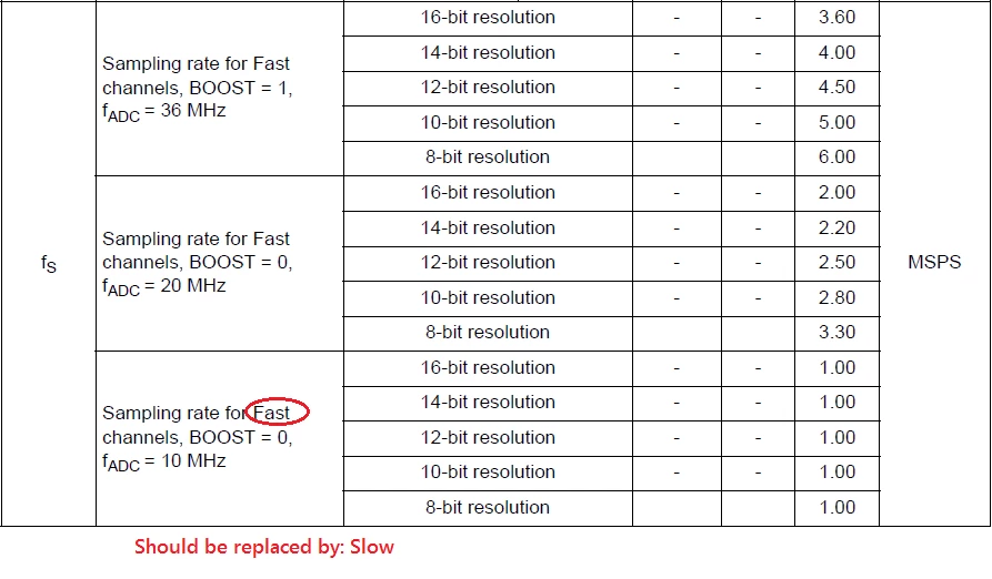

    The STM32H743xI Reference manual (RM0433) section 25.3.13 'Channel-wise programmable sampling time (SMPR1, SMPR2) -> Constraints on the sampling time for fast and slow channels' says:
    For each channel, SMP[2:0] bits must be programmed to respect a minimum sampling time as specified in the ADC characteristics section of the datasheets.
    But the STM32H743xI datasheet Rev.3 section 6.3.20 '16-bit ADC characteristics' not contain the specification for slow channels.
    For example, the STM32L496xx datasheet the accuracy, sampling rate etc. is specified for both  ADC channels
    In addition, Table 78. 'ADC accuracy' (ENOB, SINAD, SNR, THD) not contain information about analog input frequency.
    Is it possible to obtain more detail data on the STH32H7 ADC performance?
    Thanks
    Singh.Harjit
    Senior
    April 29, 2018
    Posted on April 29, 2018 at 19:02
    Am assigning pins and would like to know the fast / slow ADC channel characteristics. Please provide info. or timeline. Thanks.
    Vladimir Vershinin
    Visitor II
    May 3, 2018
    Posted on May 03, 2018 at 09:33
    I applied to ST online technical support and their response was:
    ''In fact there is a typo in the datasheet. ''Fast'' should be replaced by ''Slow''
    in the last line in the table in the datasheet as shown by the attached image.
    This will be corrected in the next version of the datasheet.''

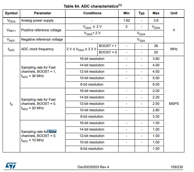

    June 7, 2018
    Posted on June 07, 2018 at 11:44
    We corrected this typo in the ''ADC characteristics'' table for the STM32H753xI datasheet Rev4 which is available since 18-May-2018.
    Thank you for bringing this issue to our attention.
