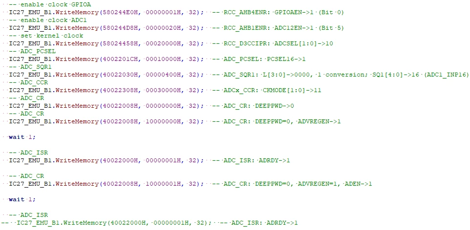

Visitor II
August 29, 2024
Hi, i know its a long time ago but i just had the same problem and want to share my solution.
For me it was not so easy because there are many configurations to do.
This example is for reading adc-value from port PA0 (ADC1_INP16) on STM32H755
Regards, Chris
