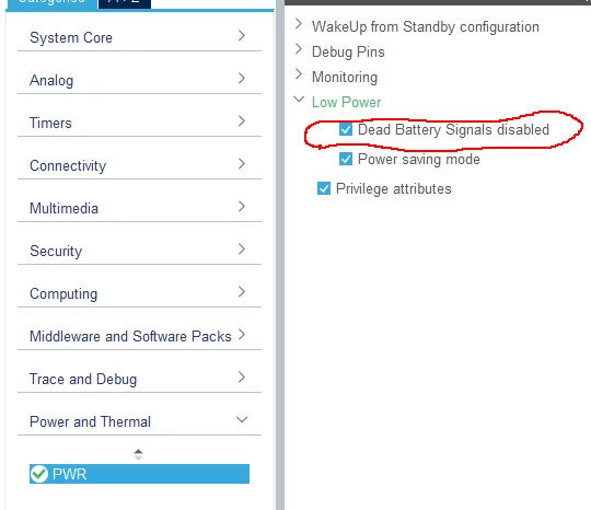

PR.10
Jan 26, 2026 8:59 PM UTC
For future developers having the same wtf moments.
You can call HAL_PWREx_DisableUCPDDeadBattery(), write the registers directly or there is actually a checkbox in the IDE that would saved me hours of investigating ;)
