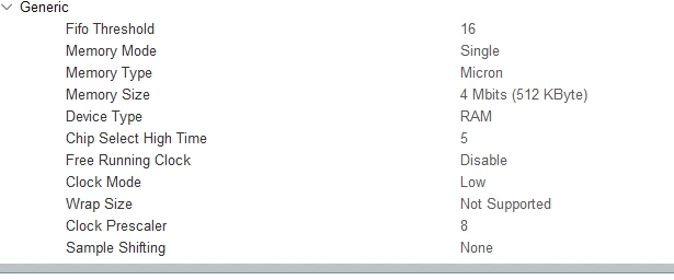

Dear Forum Members,
I'm developing a hardware with a small LCD screen which is using a QSPI interface. I succeeded with an STM32H723 with its OCTOSPI interface through DMA, and I got good results, but I encountered memory mapping problems with the complicated split RAM structure of that MCU, so I switched to an STM32H573, which has all of its 640k RAM in one continous block.
Signals used for data transmission: D0~D3, NCS, SCK. For commands and data headers, the protocol uses D0 only in 1-bit SPI mode, than pixel data is being sent in 4-bit QSPI format for each line.
I'm struggling with the XSPI interface setting up correctly for the new microcontroller, it does not send out any data (viewed on a scope), even the NCS signal is not pulled down on HAL_XSPI_Transmit or HAL_XSPI_Command calls. I think I missed some registers which are not generated by the STM32Cube IDE. I've found AN5050, which is mostly about how to attach an external memory chip through these interfaces.
I think I missed setting up or initializing some functions which were not set up completely by the CubeIDE.
Working init code I used for the previous MCU generated by STM32Cube IDE, and added some default headers for commands:

static void MX_OCTOSPI1_Init(void)
 /* USER CODE BEGIN OCTOSPI1_Init 0 */
 /* USER CODE END OCTOSPI1_Init 0 */
 /* USER CODE BEGIN OCTOSPI1_Init 1 */
 /* USER CODE END OCTOSPI1_Init 1 */
 /* OCTOSPI1 parameter configuration*/
 hospi1.Instance = OCTOSPI1;
 hospi1.Init.FifoThresholdByte = 16;
 hospi1.Init.MemoryMode = HAL_XSPI_SINGLE_MEM;
 hospi1.Init.MemoryType = HAL_XSPI_MEMTYPE_MICRON;
 hospi1.Init.MemorySize = HAL_XSPI_SIZE_16B;
 hospi1.Init.ChipSelectHighTimeCycle = 5;
 hospi1.Init.FreeRunningClock = HAL_XSPI_FREERUNCLK_DISABLE;
 hospi1.Init.ClockMode = HAL_XSPI_CLOCK_MODE_0;
 hospi1.Init.WrapSize = HAL_XSPI_WRAP_NOT_SUPPORTED;
 hospi1.Init.ClockPrescaler = 50;
 hospi1.Init.SampleShifting = HAL_XSPI_SAMPLE_SHIFT_NONE;
 hospi1.Init.DelayHoldQuarterCycle = HAL_XSPI_DHQC_DISABLE;
 hospi1.Init.ChipSelectBoundary = HAL_XSPI_BONDARYOF_16B;
 hospi1.Init.DelayBlockBypass = HAL_XSPI_DELAY_BLOCK_BYPASS;
 hospi1.Init.Refresh = 0;
 if (HAL_XSPI_Init(&hospi1) != HAL_OK)
 Error_Handler();
 /* USER CODE BEGIN OCTOSPI1_Init 2 */
 /* USER CODE END OCTOSPI1_Init 2 */

Then, in the main loop I tried to send out something:
(also tried with Transmit_IT or Transmit_DMA but the same result, software runs)
If I set free running clock ON, then the clock can be seen on the scope.

PThieringBest answer
Jan 9, 2025 12:54 PM UTC
I think the problem was resolved. There's a "memory size" setting in CubeMX which had to be set to "512k / 4mbit" and then the thing begon sending data. Idk why...
For further reference, there was the fix.
