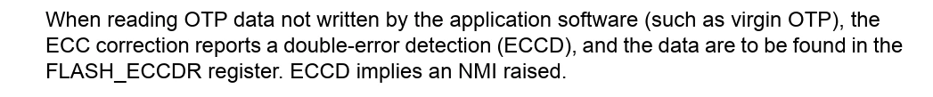

I'm trying to read the OTP flash form my application but I get a hardfault.
Is there a read protection or something like that?
 Here is a code snippet:
#define FLASH_START_ADDRESS 0x08FFF000
int main(void) {
 HAL_Init();
uint32_t* flash_data = (uint32_t*)FLASH_START_ADDRESS; uint32_t data = *flash_data;
Best answer by mƎALLEm
From Reference Manual: it's due to this:
Please refer to this thread.

maybe....from rm :

I think that should not result in a hard fault
