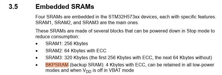

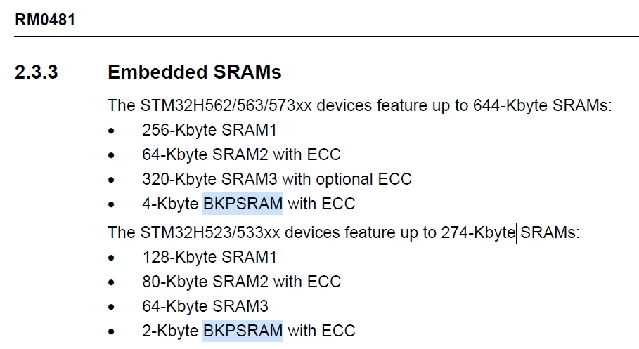

STM32H573 - missing BKPSRAM on memory map
The datasheet and reference manual are missing information about the 4 KB Backup SRAM in the memory map.
Where can I find details about it?
We need to use this memory in both Secure and Non-Secure projects.
Thank you.

Hello @RZub ;
You can refer to Table 5. Memory map and peripheral register boundary addresses (STM32H562/563/573xx) in RM0481 Rev 4: to find adresses:
Non-secure boundary address :0x4003 6400 - 0x4003 73FF
Secure boundary address: 0x5003 6400 - 0x5003 73FF

RZub
RZubAuthor
February 4, 2026
Yes, this answers my question. Thank you!
The confusion was mainly due to naming: I was searching for BKPSRAM, while in this context it is referred to as BKPRAM. That’s why I couldn’t find it initially.
Thanks again for the clarification.
mƎALLEm
February 4, 2026
From RM0481, Table 6. Memory map and peripheral register addresses
