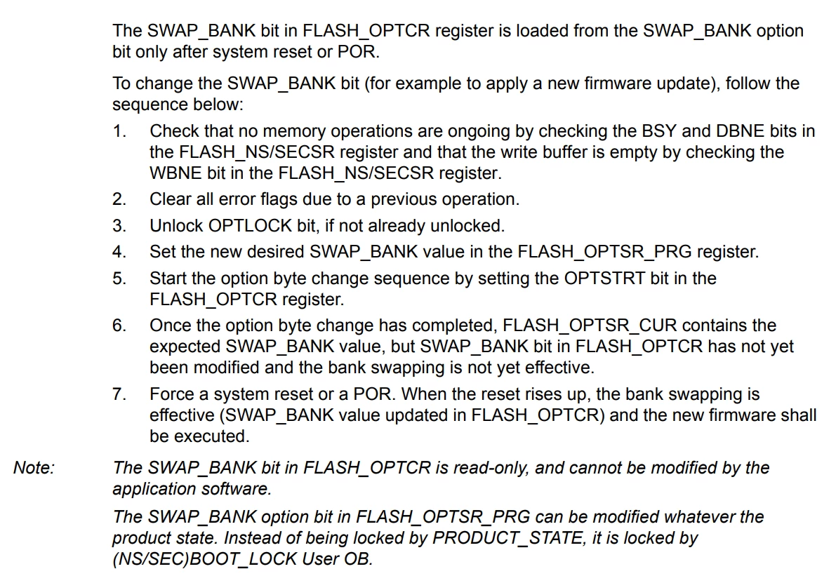

Hi, I'm following the steps on the reference manual to perform in-application programming by first writing the new firmware to bank 2 and then swapping the banks after doing some checks.
After completing the steps and performing a software reset, the new firmware was updated. However, after closing the st-link debugger and reopening it, the debugging session immediately closes. I'm trying to figure out why.

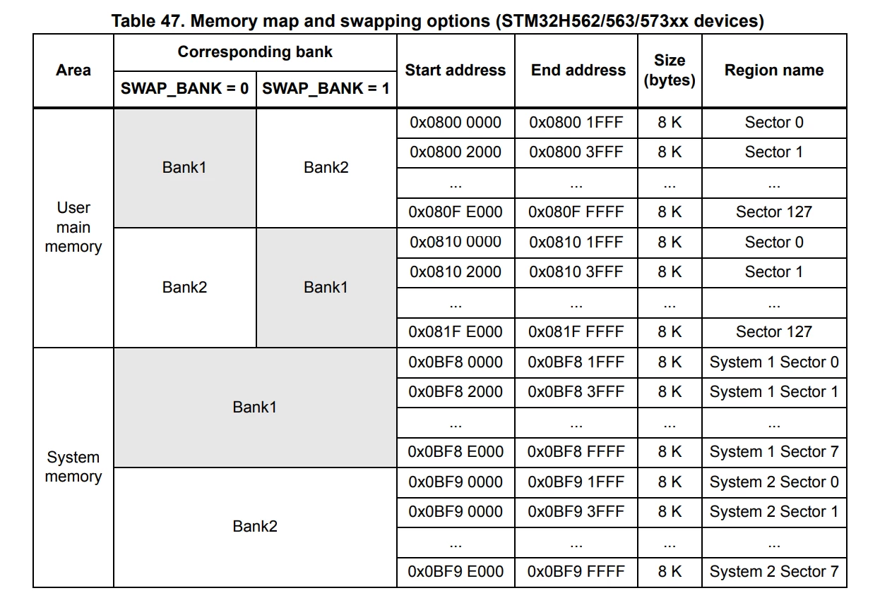

I have written the new firmware starting at address 0x0810 0000 according to the following:
I was wondering whether I need to offset by a couple sectors from the 0x810 0000 start address before flashing new firmware. Please let me know I'm mistaken, thanks.

Well if you have common code at 0x0800000 and 0x08100000 you can at least fork() between the two regions with the bank switch. Perhaps a couple of KB for a loader/recovery method.
You need to link the image for the address it's going to physically execute, not necessarily where you have it parked before it's swapped around.

I'm still having issues with this; there is a flaw in my implementation that I'm failing to identify.
My current implementation is doing the following (in the order provided):
1. Write new firmware to the start address of Bank 2 (0x0810 0000). I'm reading back the contents of the memory locations that I wrote to and I have verified that they are correct.
2. Then, I followed the instructions, provided on p265 of RM0481 Rev 2, to change the SWAP_BANK bit to apply a new firmware update.
3. Finally, I update the vector table offset SCB->VTOR = 0x0810 0000 before locking option control registers access and flash control registers access. However, the program terminates when the SCB->VTOR = 0x0810 0000 line executes, and the lines responsible for locking the flash are not executed.
After the final step, the new firmware was successfully uploaded based on the print statements in my serial console. However, debugger mode terminates immediately. When I try to debug again, I get the following in the debug console and I can't program/debug the micro anymore:
Remote communication error. Target disconnected.: Arg list too long.
GDB session ended. exit-code: 0
GDB never responded to an interrupt request. Trying to end session anyways
Based on the debug console, there seems to be an issue with servicing a specific interrupt. I thought that updating the vector table offset would solve the issue, but it did not. Any further guidance would be appreciated.

Unless you're running identical code in FLASH, you can't BANK_SWAP from code running in FLASH. Even calling a routine in RAM probably won't help as when it returns it's going to go to the same address in the other bank. If the code is different, expect it to crash.
I mention fork() as its the UNIX way of taking a common code image and starting a second copy of one's self.
As I originally suggested, consider a common / identical loader, perhaps 2 or 4KB, that lives in both banks, and decides which to map, and then branches in through the Reset Handler for the vector table parked at 0x08001000 (base + 4KB)
Yes, SCB->VTOR typically gets set up in SystemInit(), it could use an address from the linker for the vectors rather than the #define mess ST uses.
