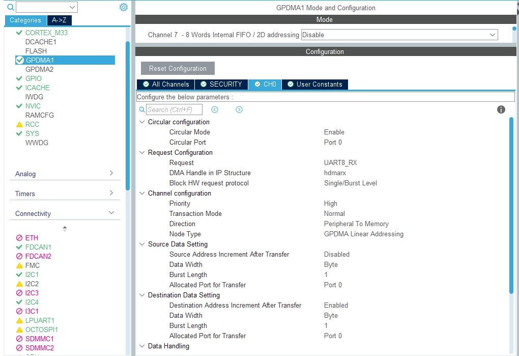

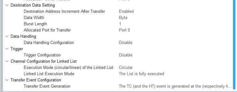

MES98Author
Apr 14, 2026 8:19 AM UTC
@unsigned_char_array @Ozone @Michal Dudka @Andrew Neil
Thank you for your suggestions.
I have now started using DMA for UART reception as recommended. However, I may be doing something wrong since I don’t have much experience with DMA yet.
I am sharing the relevant part of my code and my clock configuration for reference.
Current behavior:
  • With DMA, communication works only at 115200 baud
  • At 230400 baud, I already start getting overrun errors
Additionally, I noticed something unexpected:
  • If I remove the following line:
HAL_UART_IRQHandler(&huart8);
  • Then inside my UART_ProcessData function, hdmarx becomes 0, and it behaves as if no data is being received at all
This makes me think that I might be misconfiguring the interaction between DMA and interrupt handling, but I’m not sure what I am missing.
Any guidance on correct DMA + UART configuration or what I might be doing wrong would be greatly appreciated.

Ozone
Principal
Apr 14, 2026 9:51 AM UTC
The idea of DMA (or a FIFO) ist to not have UART interrupts in the first place.
You should only need to process DMA interrupts (complete transfers of your configured size). And errors, of course.

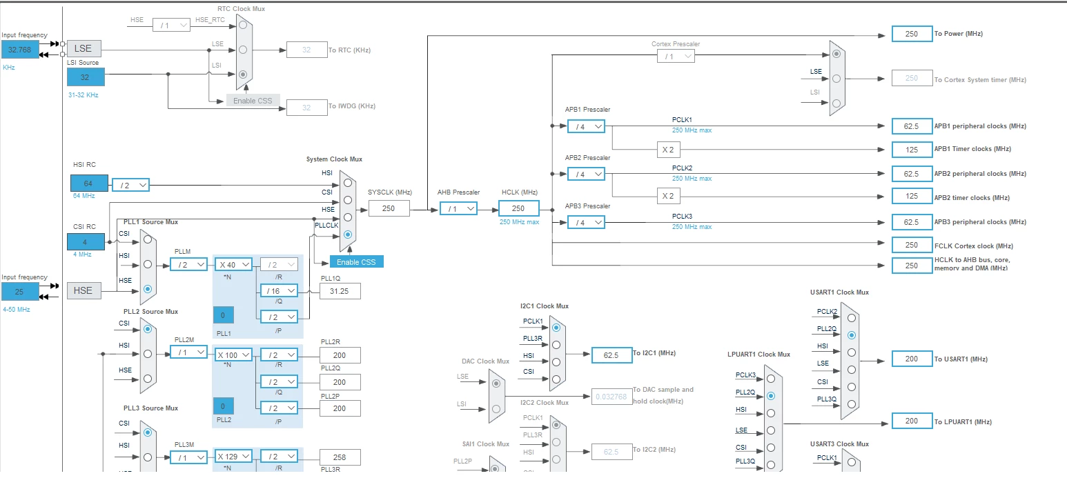

MES98AuthorBest answer
Apr 15, 2026 3:06 PM UTC
Thank you all for your support and valuable suggestions.
I would like to briefly summarize the issue and the solution, in case it helps others in the future.
Initially, when using interrupt-based reception, I was able to reach up to around 4 Mbaud reliably.
After switching to DMA, I was able to increase this up to 8 Mbaud.
However, I could never reach the 10 Mbaud value stated in the datasheet — at that speed, I was neither able to receive nor transmit data reliably.
While going through the datasheets more carefully, I noticed that the UART clock is 24 MHz, and in simple terms, the achievable baud rates follow a relation like 24 / n (Mbaud).
Based on this, I tested different baud rates again:
  • My device still cannot reliably communicate at 10 Mbaud
  • But interestingly, it works perfectly at 12 Mbaud
So it seems that certain baud rates are more “naturally aligned” with the clock configuration, while others are not achievable due to divider limitations.
Thanks again to everyone for the help.
Have a great day!
Andrew Neil
Apr 15, 2026 3:11 PM UTC
Yes, this is common.
This is why there are crystals manufactured with what seem like strange frequency values - like 11.059MHz.
That number is chosen precisely because it easily divides to give common serial baud rates.
unsigned_char_array
Lead III
Apr 15, 2026 4:40 PM UTC
And it's why fractional baudrate exists. If a desired baudrate is close to 2 possible baudrates the peripheral can periodically switch between those baudrates per bit so the sample point doesn't drift too much. It's the same principle we use for leap years.
