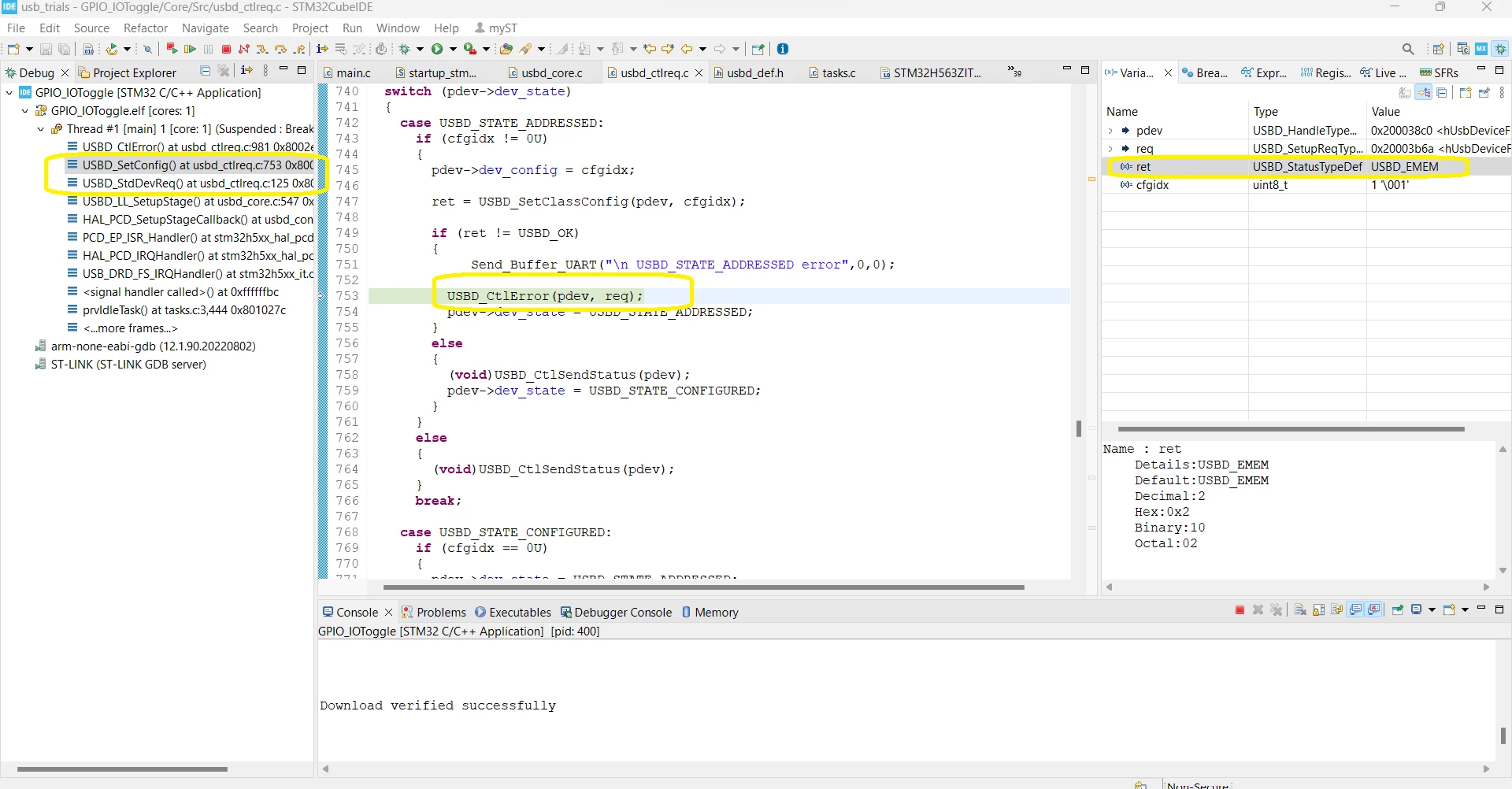

STM32H563ZI : USB CDC issue
Hello ,
As per reference document added USB driver in firmware , but gives error at function
USBD_SetClassConfig(pdev, cfgidx);
added screenshot of error
If ignore this error , USB Serial device port detected but failed to set transmission buffer

    Go into USBD_SetClassConfig and figure out why it's failing. Set a breakpoint, step through.
    poojaAuthor
    Dec 4, 2023 10:53 AM UTC

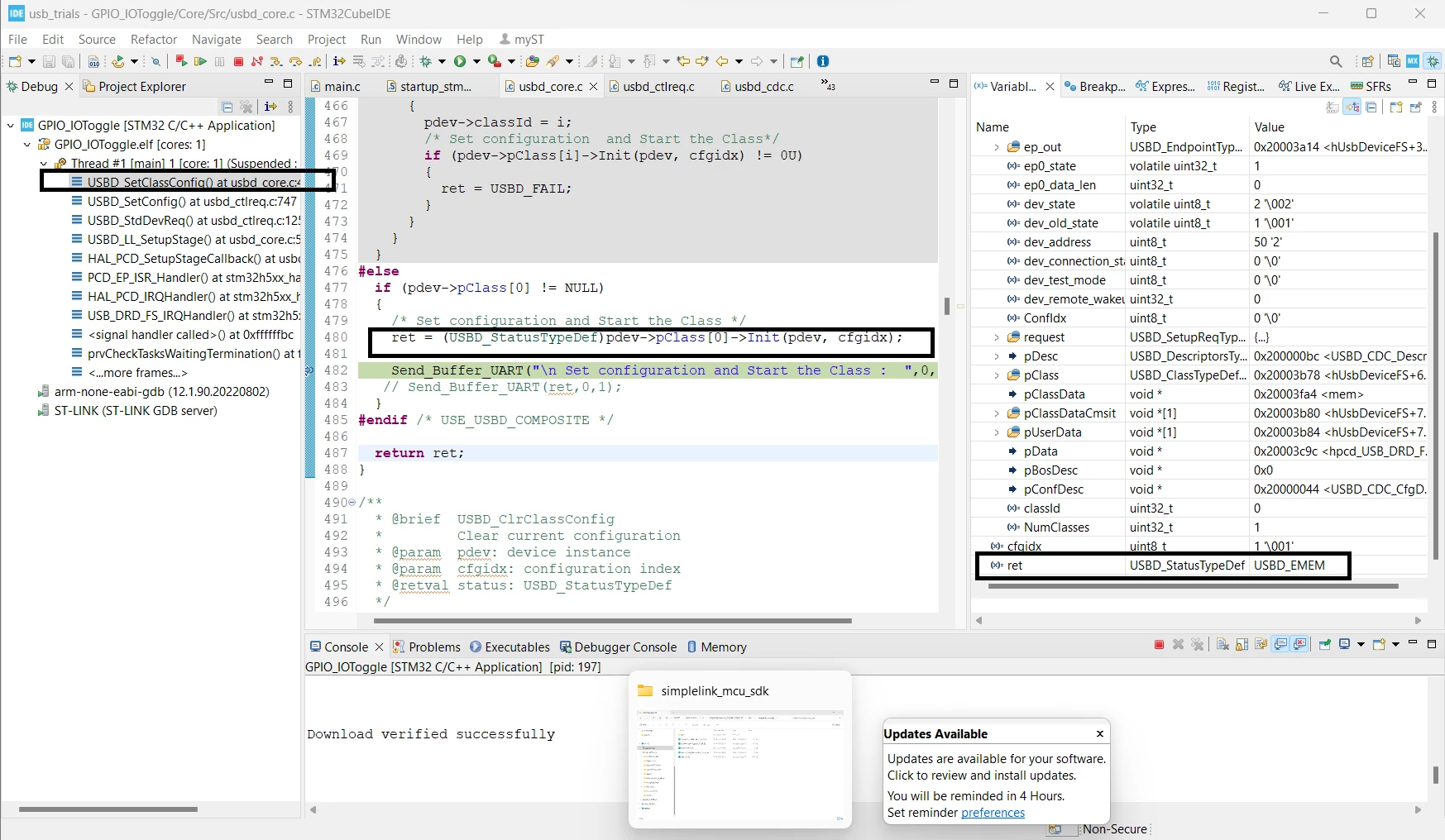

    Hello ,
    USBD_EMEM error received in USBD_SetClassConfig
    Dec 4, 2023 1:57 PM UTC
    Keep following it. Go into the Init function and find where that failed...

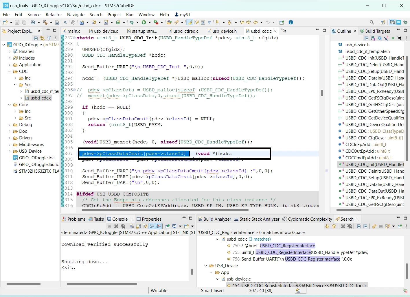

    poojaAuthor
    Dec 5, 2023 9:08 AM UTC
    it will fail in CDC_INIT function
    pdev->pClassDataCmsit[pdev->classId] always return a NULL value
    Dec 5, 2023 2:22 PM UTC
    Step through USBD_malloc and understand why it's failing. On newer HAL USB versions, this is a static allocation which can never fail. On older ones it called malloc, which should work, but may not if you have insufficient heap space.
    USBD_EMEM indicates a memory error.
