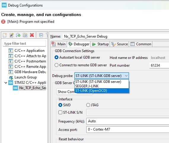

The ST fork of OpenOCD is bundled with CubeIDE and it supports STM32H5. Just specify OpenOCD in your debugger configuration instead of "GDB server". It will create .cfg file for OpenOCD. If this does not work please report a bug.

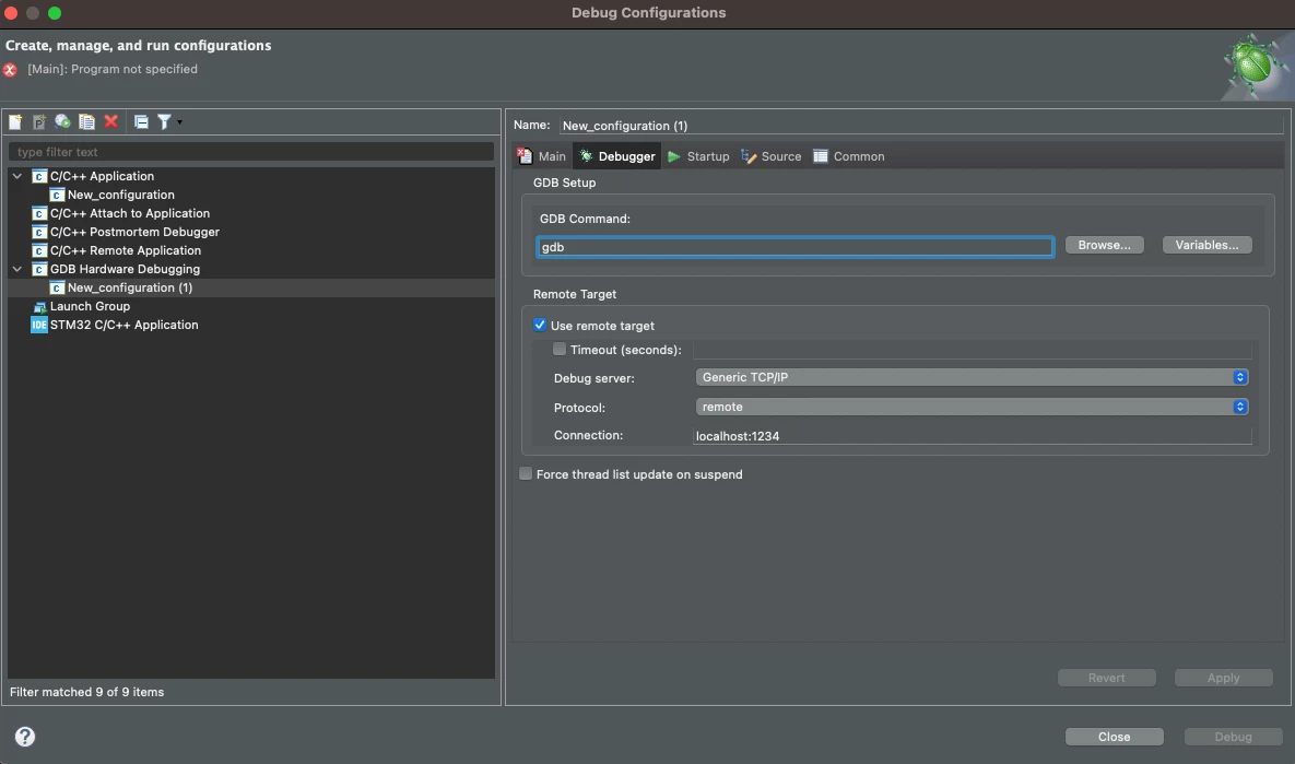

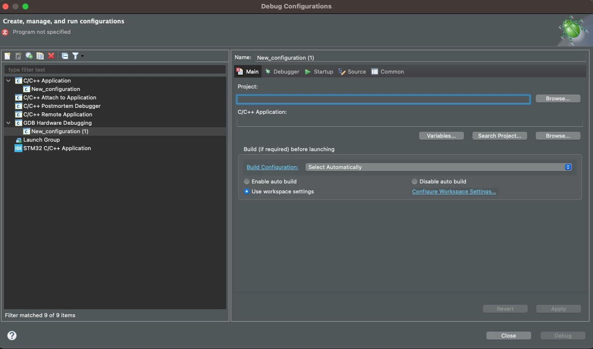

I am not seeing OpenOCD as an option. Also, my ultimate goal is to use Rust as a programming language. It looks like CubeIDE does not support this. What would be the best way to get this to work.Screenshot 2024-02-28 at 7.55.12 PM.pngScreenshot 2024-02-28 at 7.54.20 PM.png

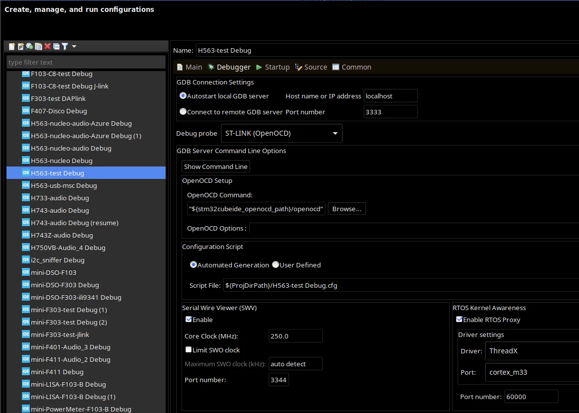

As Pavel writes, select stm32...appli. , like mine here:

Select STM32 application. You've selected generic C++ app. (no idea why they left it in the menu).
