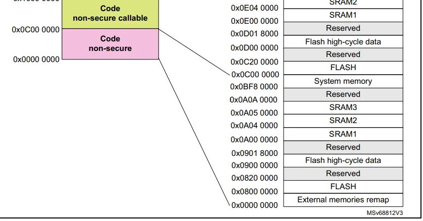

Foued_KH
Sep 6, 2023 3:24 PM UTC
Hi @Recep ,
You need to modify the SRAM address as showing :
SRAM1 : 0x0A00 0000
SRAM1 : 0x0A04 0000
SRAM1 : 0x0A05 0000

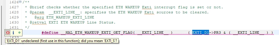

Egolt.1
Apr 3, 2024 4:54 PM UTC
Hi @Recep, I tried to follow your suggestion of using the files in FreeRTOS-Plus-TCP\source\portable\NetworkInterface\STM32Hxx for STM32H5 by just renaming the relevant H7 files to H5 but I have this compiler error at stm32hxx_hal_eth.h that seems to refer a define that H5 does not have (In the H7 version it is exist in stm32h743xx.h):
How did you resolve this?
