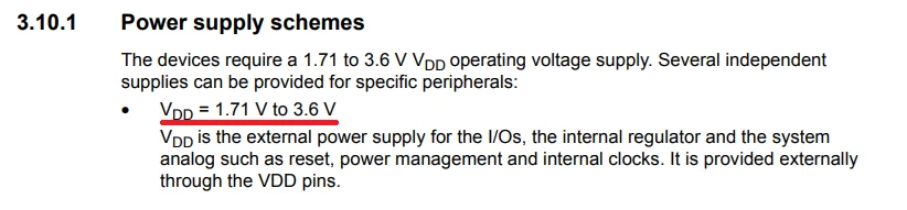

Hello ​@vikask1983 and welcome to the ST community,
As stated in the datasheet:
The minimum VDD level required is 1.71V / across the full temperature range.
But be careful at 1.8 V nominal, your margin above the retrieved VDD minimum of 1.71 V is only 90 mV.
So the documentation supports 1.8 V operation, but your board-level regulator tolerance, drop, ripple, and worst-case conditions must still keep VDD above 1.71 V across the full operating range.

That depends on your power design. You should ensure the VDD voltage doesn’t go below 1.71V. That’s it.
and probably may vary by 5% due to temperature/component variations.
5% is at the voltage limit 1.8V-5% = 1.71V!
