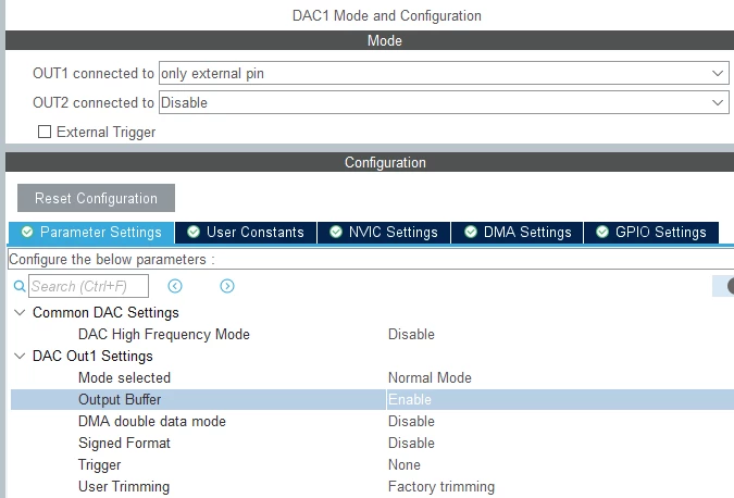

to generate 5 Hz, 50% duty cycle, 0 - 2.5v. Amplitude as expected but frequency varies from 1 - 4s and duty cycle varies from 20 - 80%: not expected. DAC1 configured like

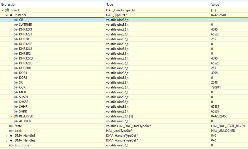

DAC1 clocked at 65 MHz. When I step into HAL_DAC_SetValue() I see where the 0 - 4095 value is written to data register (12-bit, right-aligned). But sometimes after writing 4095 the output pin reads zero; and sometimes after writing zero the output pin reads 2.5v. I can't explain why this happens. DAC Instance following write looks like
I am the only writer on the data register.

Comparing stm32h5xx_hal_msp.c from the "good" project and the "bad" project I see the "good" project has the following, which is absent from the "bad" project
 RCC_PeriphCLKInitTypeDef PeriphClkInitStruct = {0};
 if(hdac->Instance==DAC1)
 /* USER CODE BEGIN DAC1_MspInit 0 */
 /* USER CODE END DAC1_MspInit 0 */
 /** Initializes the peripherals clock
 PeriphClkInitStruct.PeriphClockSelection = RCC_PERIPHCLK_DAC;
 if (HAL_RCCEx_PeriphCLKConfig(&PeriphClkInitStruct) != HAL_OK)
 Error_Handler();
 Adding the above code to the "bad" project's stm32h5xx_hal_msp.c fixes the problem.
What needs to change in the "bad" project's IOC file to add the above code to stm32h5xx_hal_msp.c? There is nothing obvious in the GUI representations of the IOC files to explain the difference.
I am attaching IOC files from "good" and "bad" projects. I don't see anything in a diff of the 2 files to explain the missing code.
The stm32h5xx_hal_msp.c for the "good" project was generated with STM32CubeMX v6.12.0. The stm32h5xx_hal_msp.c for the "bad" project was generated with STM32CubeMX v6.13.0. At this point I am suspicious of MX 6.13.0.
