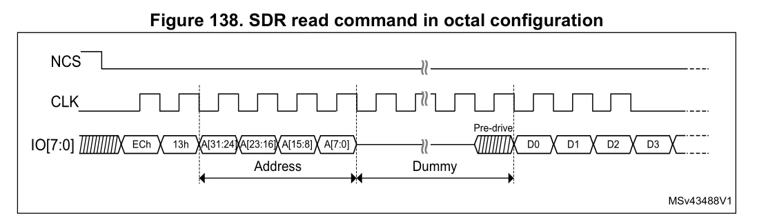

I think this depend to the Pre-drive time, but how can I calculate the effective dummy cycles to apply, to be sure that all the reading will be done correctly ?

thank you for your answer but in the STM32H5xx reference manual there is this figure about the dummy cycles

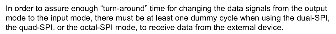

As you can see, the Dummy Cycles contains a "Pre-Drive" time that is not described in anywhere, and moreover in the same Reference Manual, speaking about the Dummy Cycle Phase, I found this:
What does it mean "there must be at least one dummy cycle" ....?? Means one, two, three, or so many?
In my opinion, I have to clarify this before ask to the memory manufacturer, because it is not clear.
