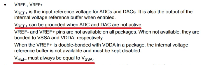

Dear Community,
Chip: STM32H563IIK6
Package: UFBGA(176+25)
we are facing an issue where the VREF (+/-) Balls are wrongly connected in the design (VREF+ on GND and VREF- on Vcc). Means the design is not working. We tried a rework to connect the Vref+/- with very tiny wires but this is very complex and the result is most time not working.
Is there any chance to let both pins floating, means we do not connect VREF+ and VREF-? This rework we can do easily.
Thanks a lot
Marwin

Unfortunately not guaranteed. You can connect VREF+ to the ground instead of VDDA but you must connect VREF- to VSSA.
From the product datasheet:

So just try it, with cut connection to VREF (+/-) ; as from ds vref has to be < 0.4V to vdda.
Obviously there are protection diodes connecting vdda to vref.
So leaving VREF (+/-) open, should be no drama, as long as you dont use any analog functions (ADC etc.)
As the the boards go to trash anyway, try it.

Hello
mƎALLEm thank you very much for the clarification.
We have eased the rework with only to connect the Vref- to GND and let Vref+ floating.
Therefore we are able to proceed with the bringup until the changed designs arrive in some weeks.
