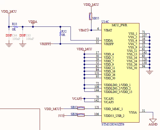

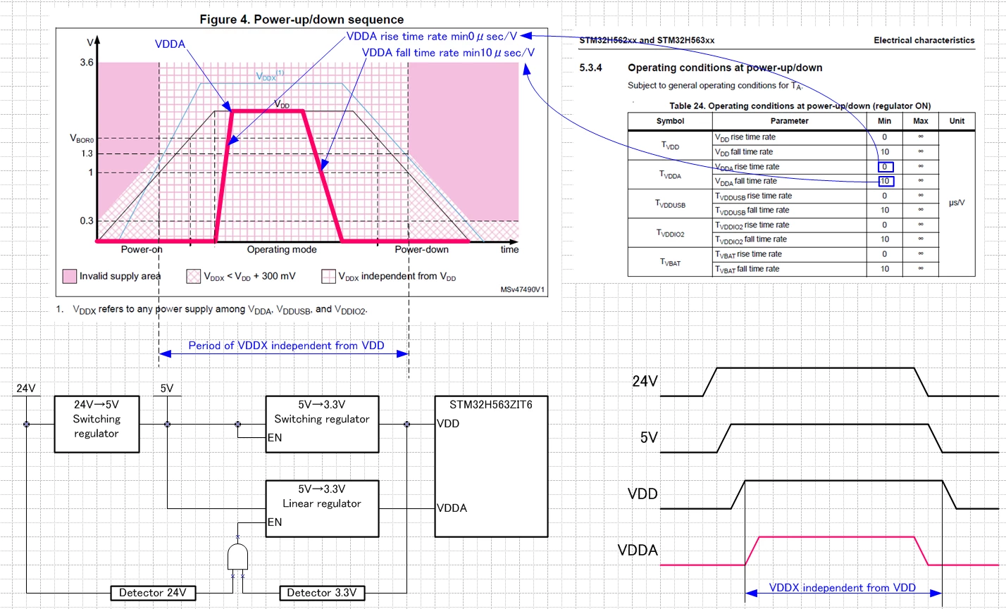

I'm thinking to control for VDDA on the STM32H563.
I'm considering by the red line in the diagram below, but are there any problems?
I'm considering when VDDX independent from VDD, can be rising and falling VDDA.
Please advise for me.
Best regard.

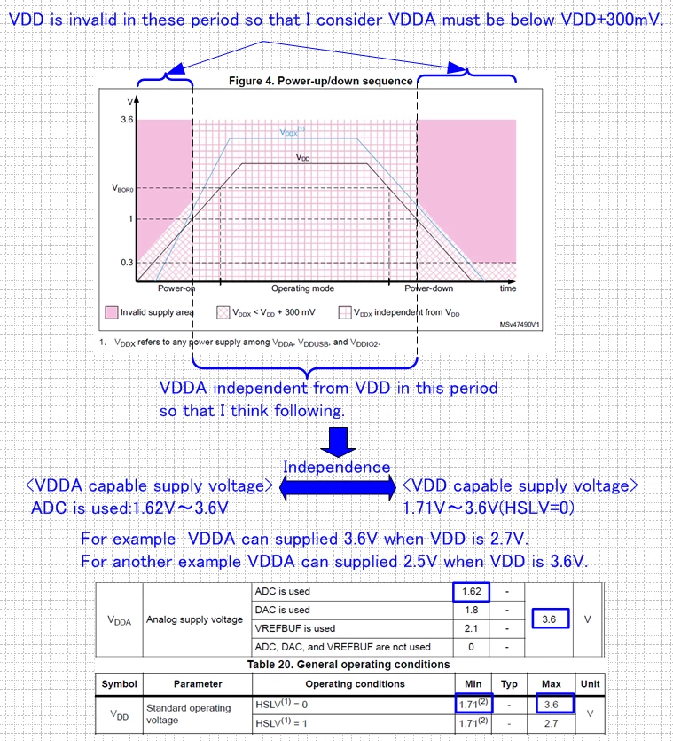

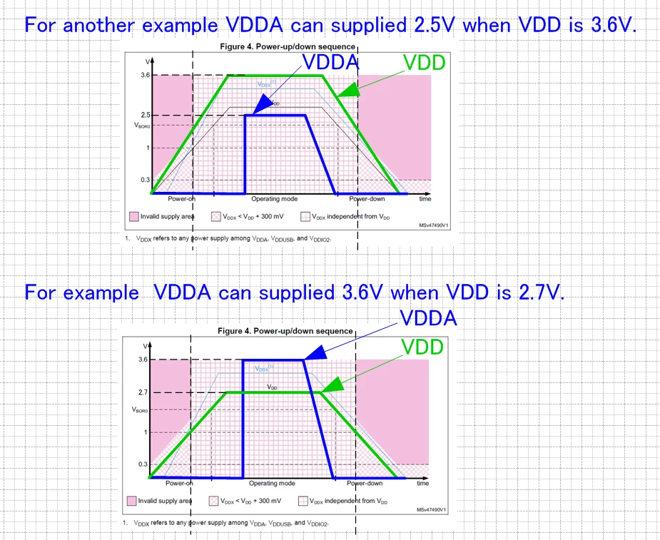

AScha.3
Mar 21, 2025 11:11 AM UTC
your plan seems ok. (just make sure, never have vdda > vdd active.)
from ds H563:
So vdda can be zero, if not using adc..etc , when vdda < 2.1V .

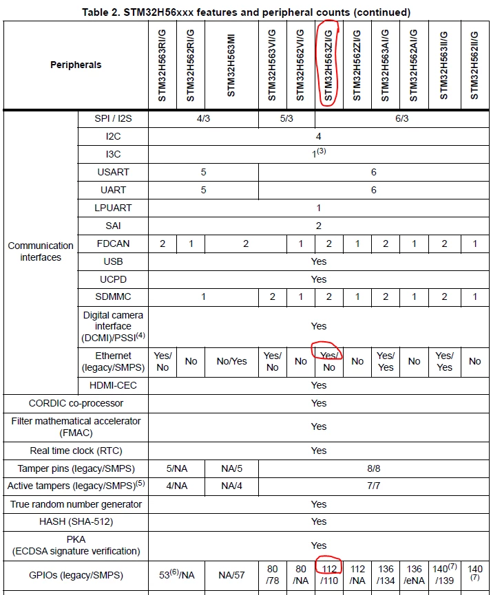

btw
If you want smps for vdd for low power consumption , why not using the version with internal smps (H56xxxxQ ) ?
tomyAuthor
Mar 24, 2025 12:51 AM UTC
Hi Chief  AScha.3.
Thank you for your advice.
I'm relieved to hear that my plan seems to be fine.
I understood as below figure when ADC using by your advice.
Is my understanding correct or wrong?
And thank you for suggesting SMPS model.
I want to use Ethernet and many GPIOs.
So, I'm selecting without SMPS.
Best regard.
