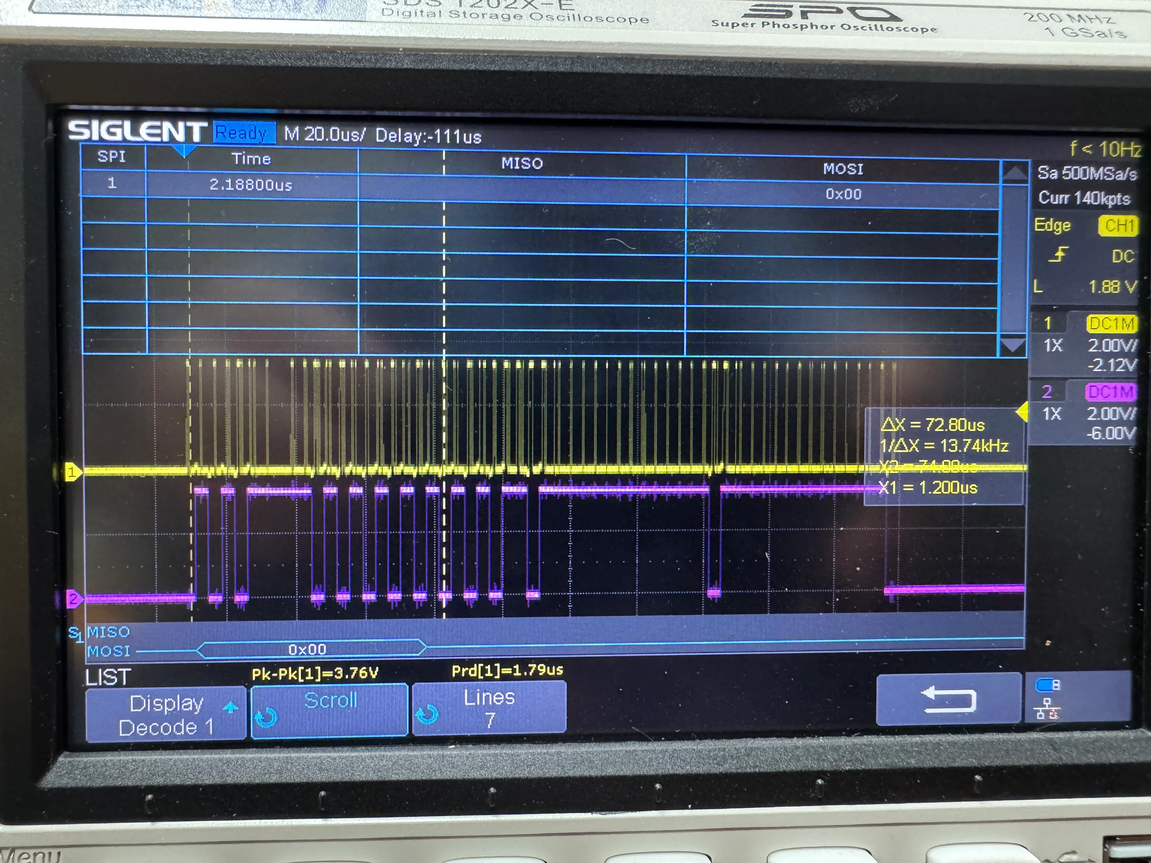

I am trying to interface a STM32H563 to an LCD using the ST7789v controller over SPI.
To test I'm just sending the LCD initialization as specified by the datasheet shown below...

Which I can confirm all this SPI data with a oscilloscope decoder for SPI.  Then I just try to fill the 240x320 screen with red....

but do not see any change...just white display.

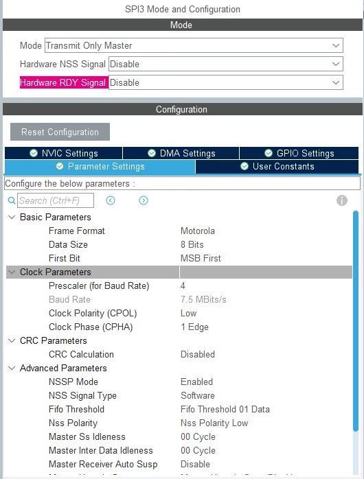

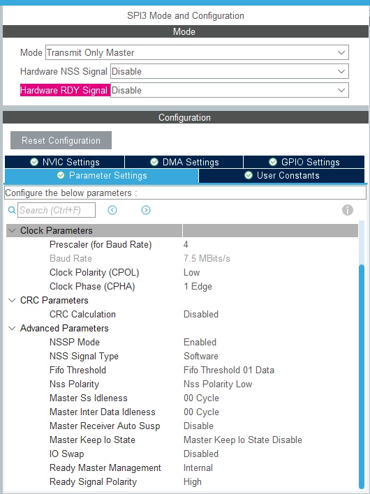

I've attached SPI .ioc configuration...any ideas what I'm missing?  Also attached shows MOSI and D/C signal lines
