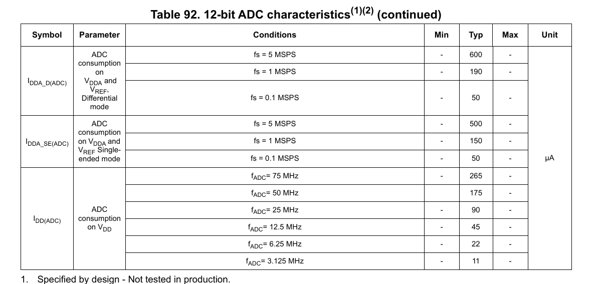

STM32H563 maximum current consumption of AD converter(RUN mode)
I searched about STM32H563 maximum current consumption of AD converter when run mode on datasheet and reference manual.
I could't find AD converter's maximum current consumpsion on datasheet and reference manual.
I want to consider external LDO for VDDA by AD converter's maximum current consumption.
Please advise for me.

see ds :
Any LDO will have more than 1mA output...even the smallest have 50mA or more max. output current.
Why ? ultra low noise LDO ? H563 has 12b ADC , so not much to gain , if VDD has LDO anyway.

tomyAuthor
Feb 14, 2025 8:39 AM UTC
Thank you for your advice.
I was searching on keyword "current consumption".
VDD need many current by logic circuit around H563,
so, generate from switching regulator circuit.
therefore, I considering LDO for VDDA.
