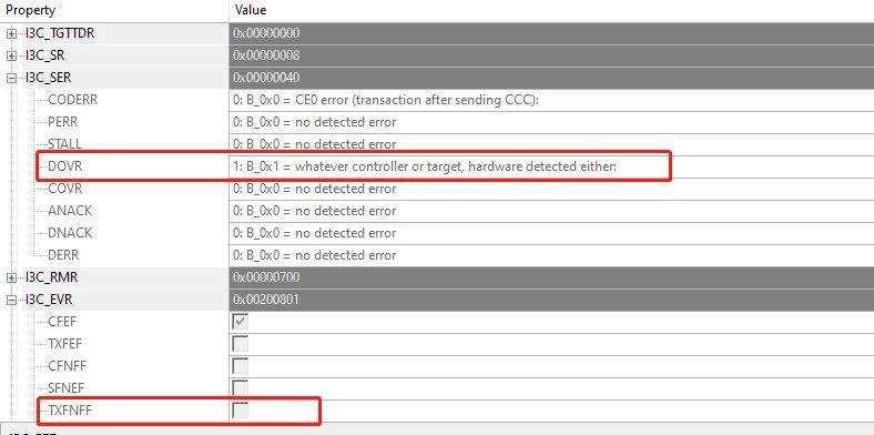

STM32H563 I3C target I3C_SER DOVR but I3C_EVR TXFNFF not asserted
  • November 11, 2024
  • 1348 views
I want ust I3C private Read as target but send only 8byte and this error to Error Handler.

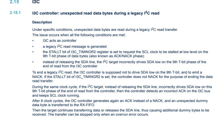

Hello @ElectronicABC
Please check if you have the condition described in the STM32H563xx Errata sheet which is related to I3C controller: unexpected read data bytes during a legacy I2C read.
November 13, 2024
some times the Controller  SCL all clock  forever and not to stop.
