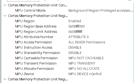

When I'm trying to read Unique device ID register on Nucleo-H563ZI, either by using HAL_GetUIDw0() or by doing
uint32_t uid1 = *((uint32_t*)0x08FFF800);
hard fault occurs.

Dear @continuum ,
You can refer to this similar case and also same solution. https://community.st.com/t5/stm32-mcu-products/using-dac-of-nucleo-h503rb/m-p/572203/highlight/true#M217994
Therefore, as mentioned by TDK you need to disable cacheability of this region of Read-Only (RO) for unique ID.
“By default, all the AHB memory range is cacheable. For regions where caching is not practical (OTP, RO), MPU has to be used to disable local cacheability.

I don't have MPU enabled. I noticed the hard fault happens only when accessing the UID register after enabling instruction cache (ICACHE).

continuumAuthor
August 24, 2023
I have no experience working with MPU but I managed to make it work.
These are the CubeMX settings that worked for me:
If I set something wrong, I would appreciate it if someone could point it out.
