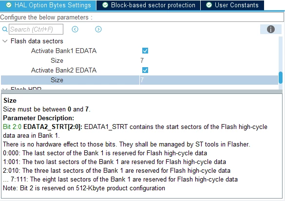

I am using the Cube Code Generator, within the STM32CubeIDE (version 1.13.1) for an STM32H563, and have configured the Flash Data Sectors to use the maximum 8 sectors per bank for EDATA. The valid range for the EDATA sector size is 0 - 7, as shown below. I believe there is a bug within the generated code for the EDATA sector size.
STM32CubeIDE Code Generation EDATA Size RangeSTM32CubeIDE Code Generation EDATA Size Range
When I choose the maximum value of 7, and follow it through the generated MX_FLASH_Init() function, I am finding that the resulting sector size that is written to the FLASH->EDATA1R_PRG and FLASH->EDATA2R_PRG registers is 1 less than what I would expect. This is because the FLASH_OB_EDATAConfig() function subtracts 1 from the EDATASize that is passed in. I have temporarily patched this by adding 1 to the EDATASize generated in MX_FLASH_Init().

Hello @lpfeiffer ,
i confirm this issue, the HAL function
is not aligned with the CubeMX HAL option bytes settings this has been reported  internally.
Internal ticket number: 166051 (This is an internal tracking number and is not accessible or usable by customers).
BR

Hello @skygreenslade ,
this was fixed by adding a note in CubeMX version 6.11 by adding the following note in the description :
0: Disable all EDATA sectors.
1: The last sector is reserved for flash high-cycle data.
2: The two last sectors are reserved for flash high-cycle data.
3: The three last sectors are reserved for flash high-cycle data
4: The four last sectors is reserved for flash high-cycle data.
5: The five last sectors are reserved for flash high-cycle data.
6: The six last sectors are reserved for flash high-cycle data.
7: The seven last sectors are reserved for flash high-cycle data.
8: The eight last sectors are reserved for flash high-cycle data.
