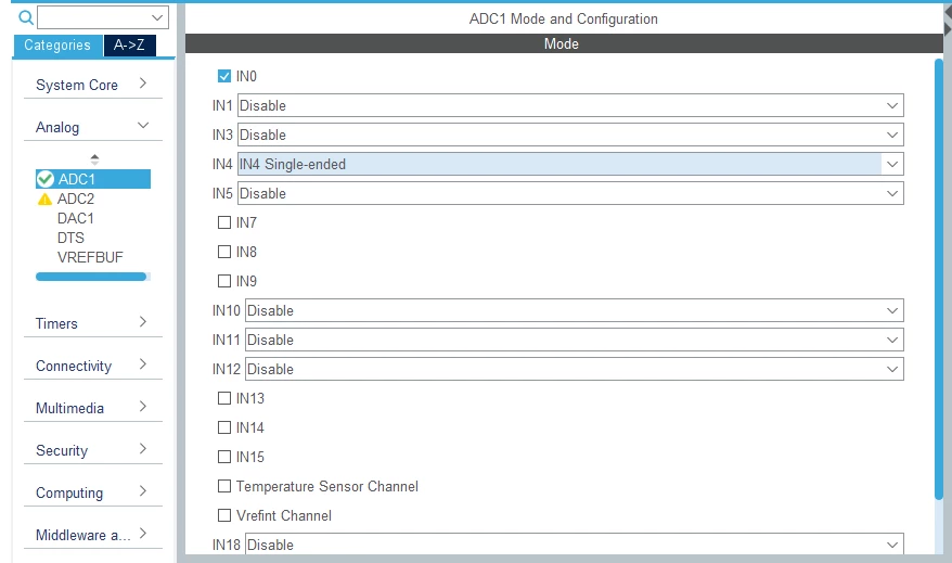

STM32H563 ADC
When configuring ADC1 with STm32CubeIDE I see no IN2 or IN6. Why?

The pins don't exist on that chip.

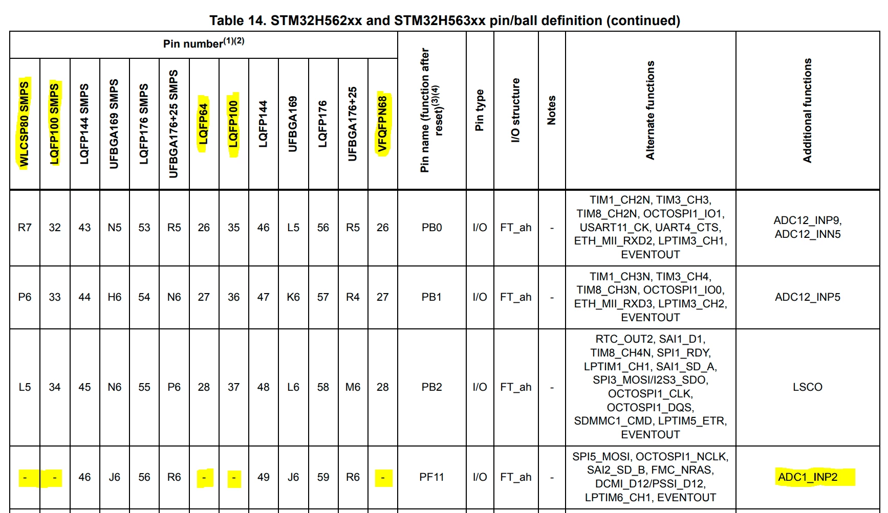

Thank you. It would be helpful if RM0481 mentioned that.

DS14258 mentions this.
August 8, 2023
Chip specific things will be found in the datasheet.
