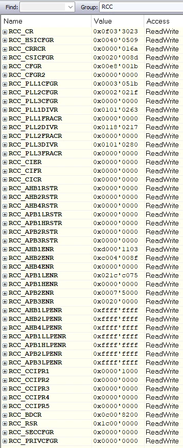

So print out the clocking the part thinks it has.
Unpack the RCC registers

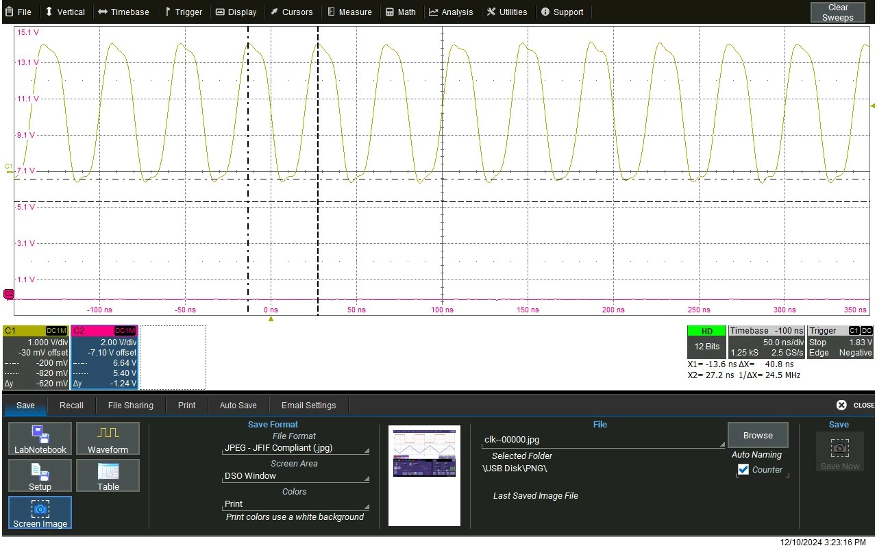

Export the internal clock via PA8 / MCO

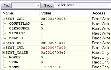

Dec 10, 2024 7:31 AM UTC
Here are registers:
And PA8:
clocksclocks
And main clock selection:
Tesla DeLorean
Guru
Dec 10, 2024 10:03 PM UTC
0x7A11 * 8 ~ 249992 seems Ok
