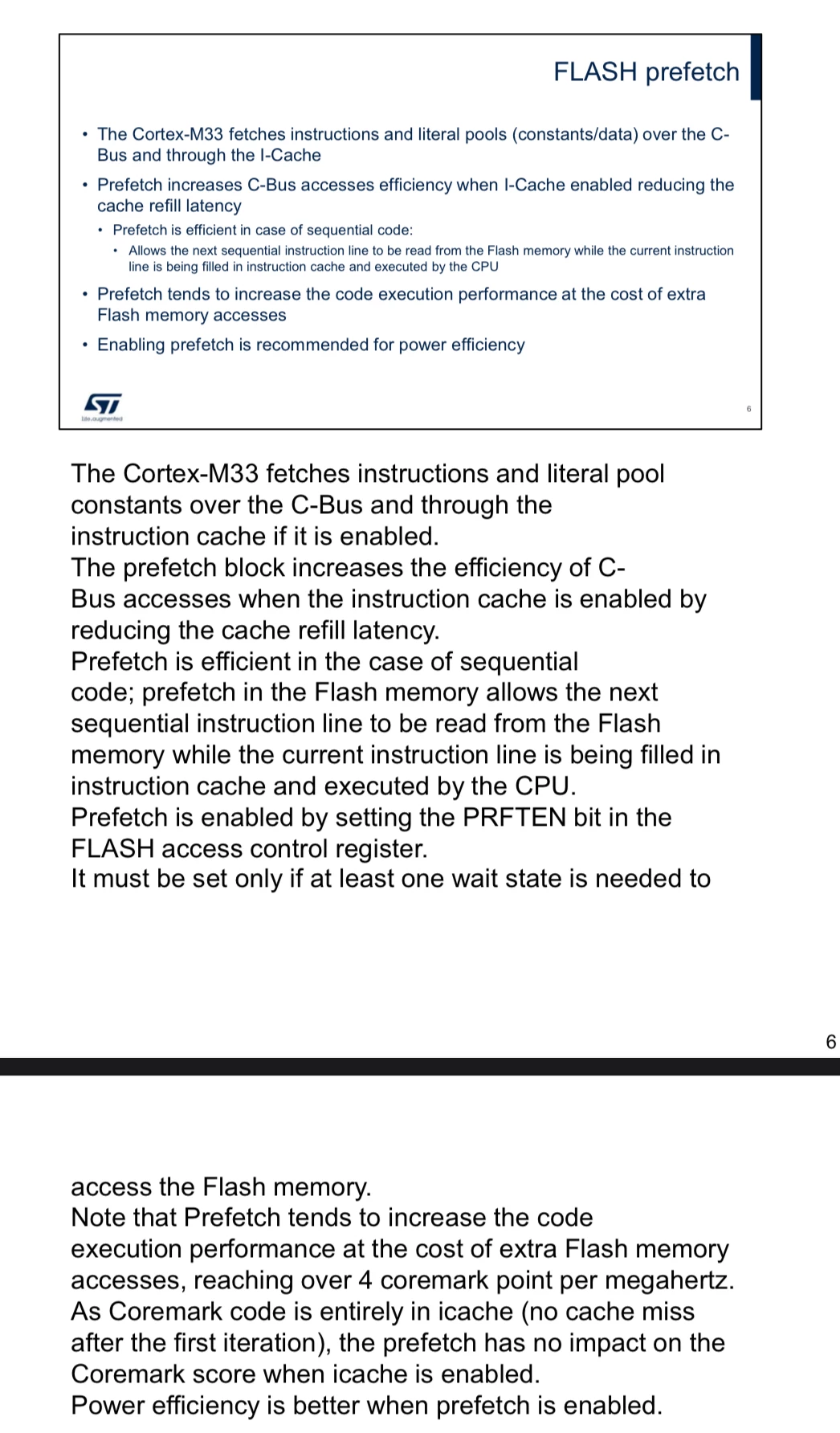

I am currently evaluating the STM32H562 device. This devices has an ICACHE (instruction cache) module.
Does it make sense to enable both, the ICACHE module and the FLASH prefetch buffer?

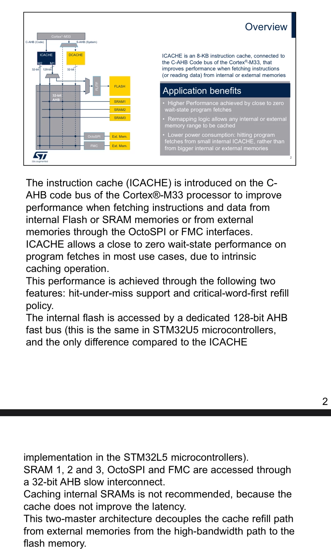

What is the difference between the "FLASH Instruction cache" of the G4 and the "ICACHE" module of the H5?

You can refer to this architecture and system diagram to have more details on differences with Cortex-M33 core vs M4 on STM32 MCUs series . The question is excellent !
Hope it helps you .

Simply the "FLASH Instruction cache" or Prefetch buffer is dedicated to the Flash but Cache implies also to other memories either internal or external so it adds access performance to other memories.

The FLASH I-cache on G4 is 1 KB, while the CPU I-cache on H5 is 8 KB and works also for SRAM and external memories. The FLASH prefetch is clearly explained in the RM0481 section 7.3.4. It's impact on performance is not so significant as from the I-cache, but it still improves the performance slightly and it makes sense to enable both. The fact that it's not present in CubeMX - well, it's your choice whether to believe the marketing nonsense about code generation and be dependent on some broken bloatware or to do an actual software development...
