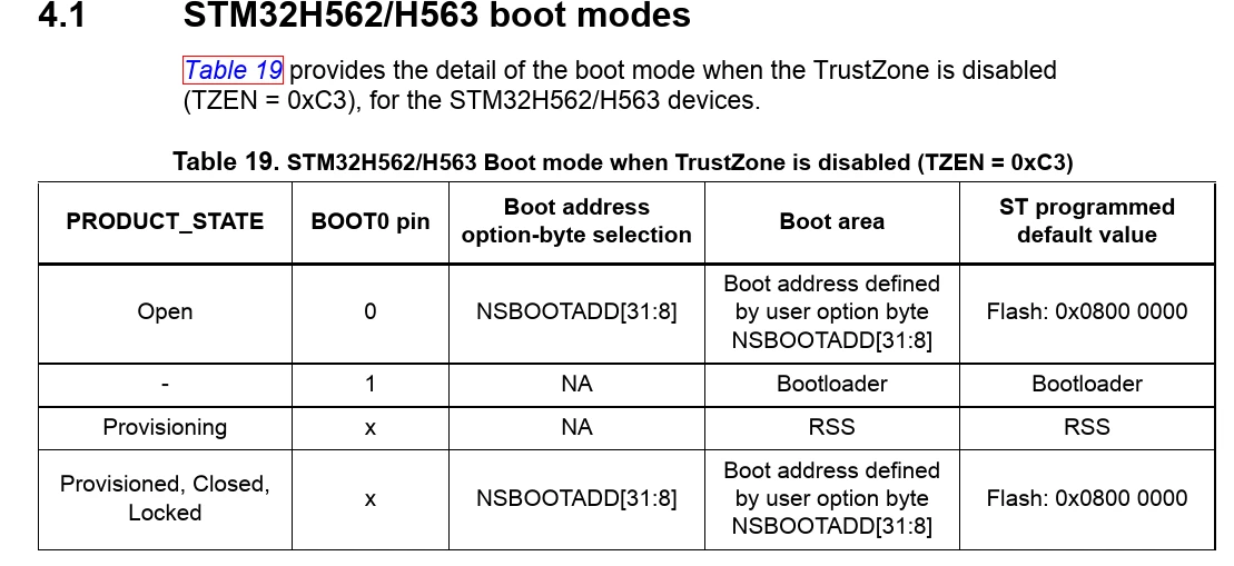

does STM32H562 have the system rom bootloader?
I cannot find it AN2606, however its datasheet does mention the system bootloader.

reading rm0481 might help :
tommz9Author
May 8, 2024
Thanks, yes this is the table I referred to in my original post. However, when I look at AN2606 it does not list STM32H562 as an option. So now I am not sure, is the reference manual wrong? Or AN2606? Or am I reading it wrong?

Hello @tommz9 and welcome to the ST Community :smiling_face_with_smiling_eyes:.
Thank you for reporting this. It is already reported to the concerned team to update the AN2606 ASAP (under internal ticket number 179001).

Hello @tommz9
The bootloader of the STM32H562 has been add to the AN2606 on the Revision 63.
