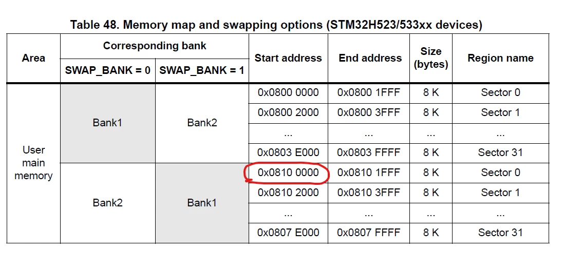

STM32H523 memory map
There seems to be an error in the reference manual RM0481 Version 2, page 264, table 48.
In the circled image I believe this should be 0x08040000. Can you anyone please confirm my deductions?
Kind Regards,
Shane
1 reply
STTwo-32
September 11, 2024
Hello @KiwiNZ
Thank you for escalating this issue. I can confirm it and I've escalated for correction on the coming doc releases (under internal ticket number 190804).
