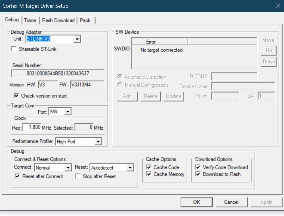

I Use the STM32H503RBT6 Nucleo Board, this is a new board, and I Tried to Connect the board with my PC using a Type C Connector But the Target is not Detect it on my PC.

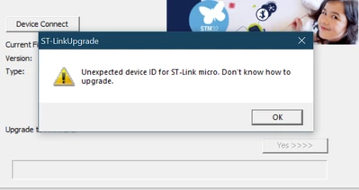

I updated the Stlink drivers and I checked the jumpers on the board, and that's all correct, then after I tried, it did not work, I tried to update the firmware on the board using St-Link utility software but it did not detect it.
I Using Keil software the Target does not detect it, but the Board LEDs or working well PWR led Glow Properly, and COM LED glows Red color only

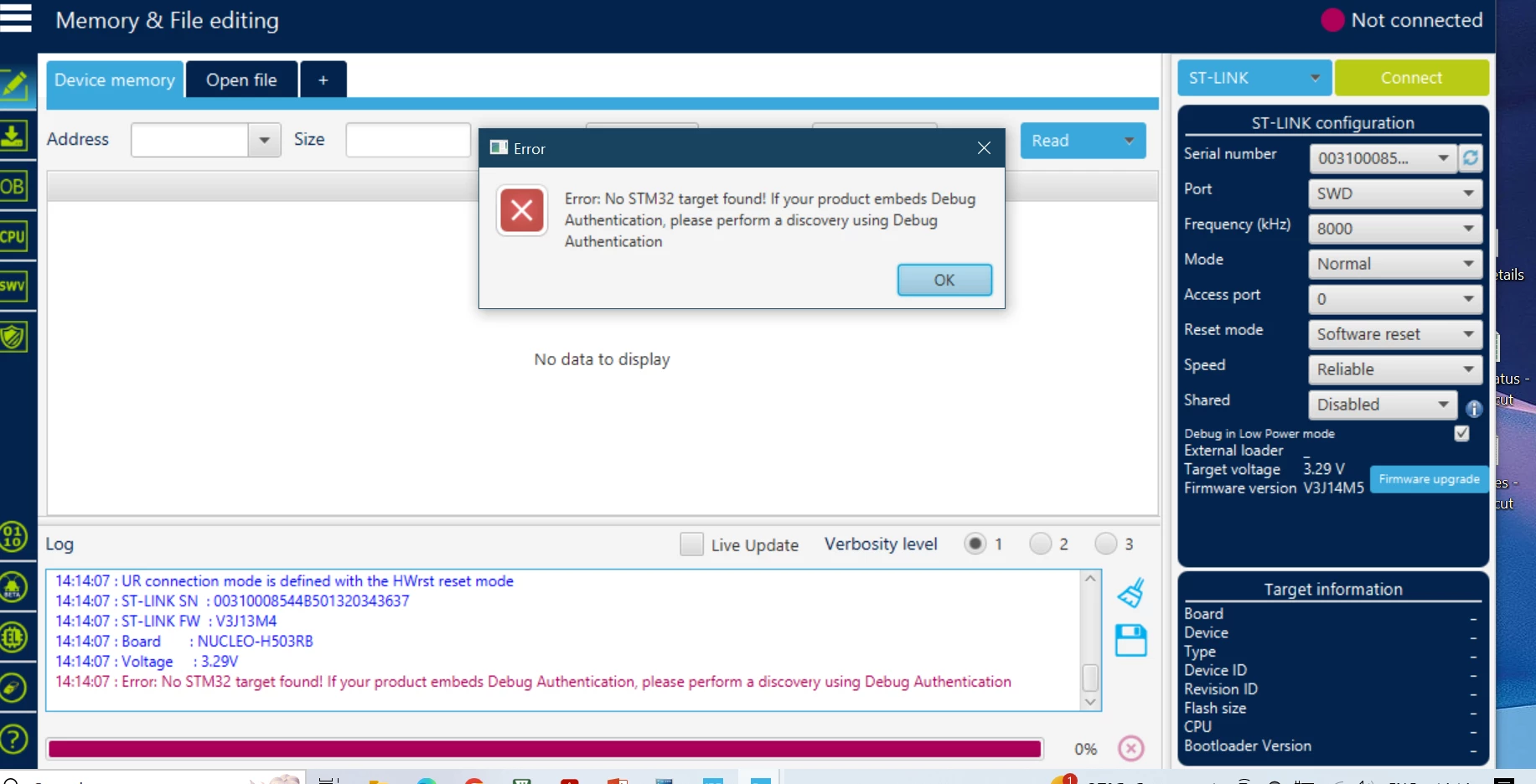

Hello @Mohan30
I suggest you try using STM32CubeProgrammer and using another Cable (a data cable and not just a charging cable).
Best Regards.

Hello, @STTwo-32
I tried it.
can you Help me to resolve the probelm. what should do next I'm so confused.
