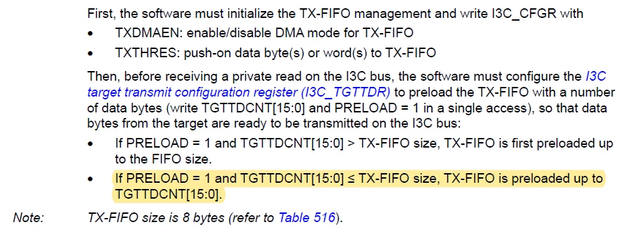

What's the minimum size of TX-FIFO available when I3C Target is reading by Controller?
I setup I3C Target TX-FIFO using function "LL_I3C_ConfigTxPreload" with 1 byte, but it always runs 8 bytes per time.
According to the datasheet, the size of TX-FIFO would be TGTTDCNT if size is lower than 8 bytes.

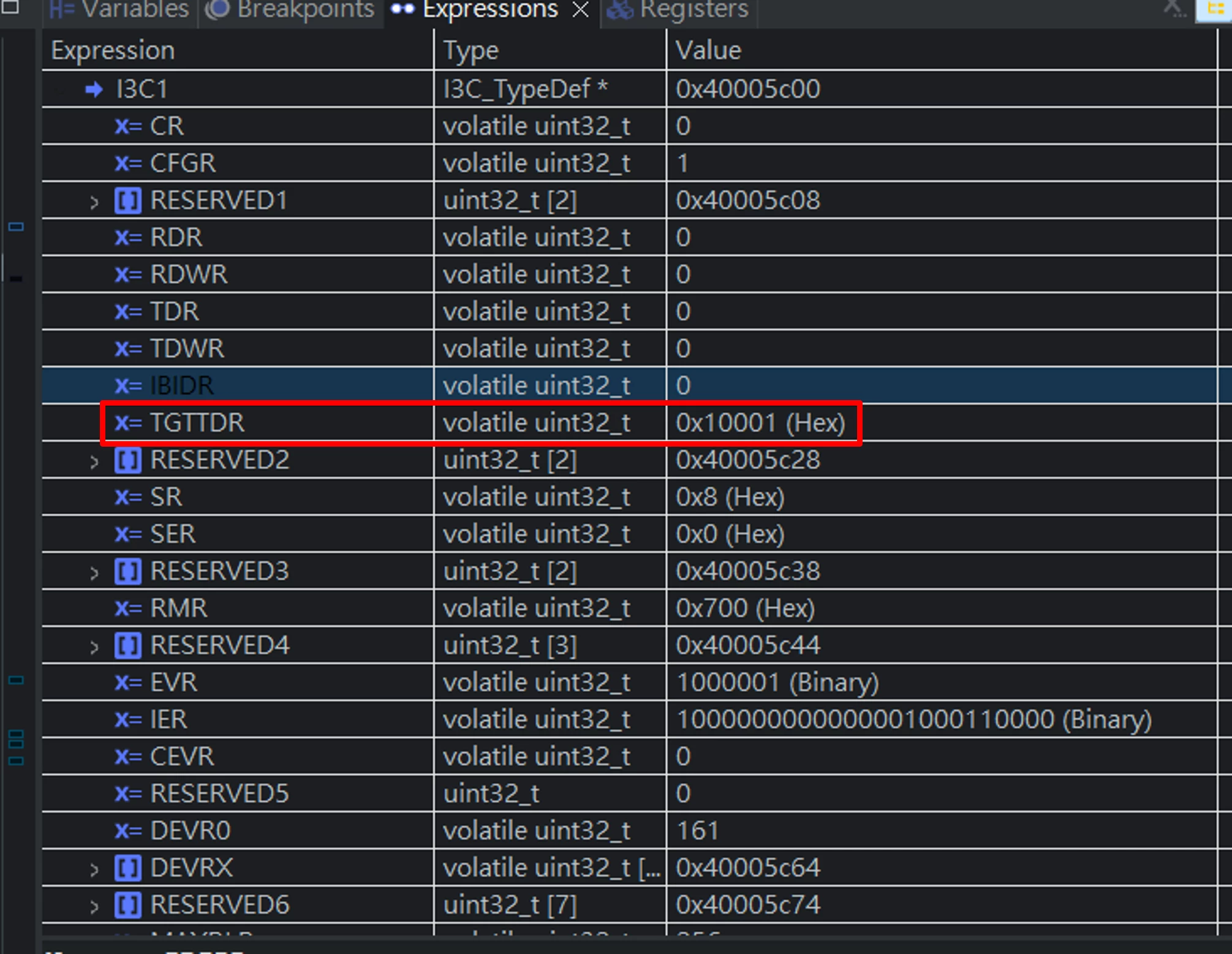

My TGTTDCNT settings:
TGTTDCNTTGTTDCNT

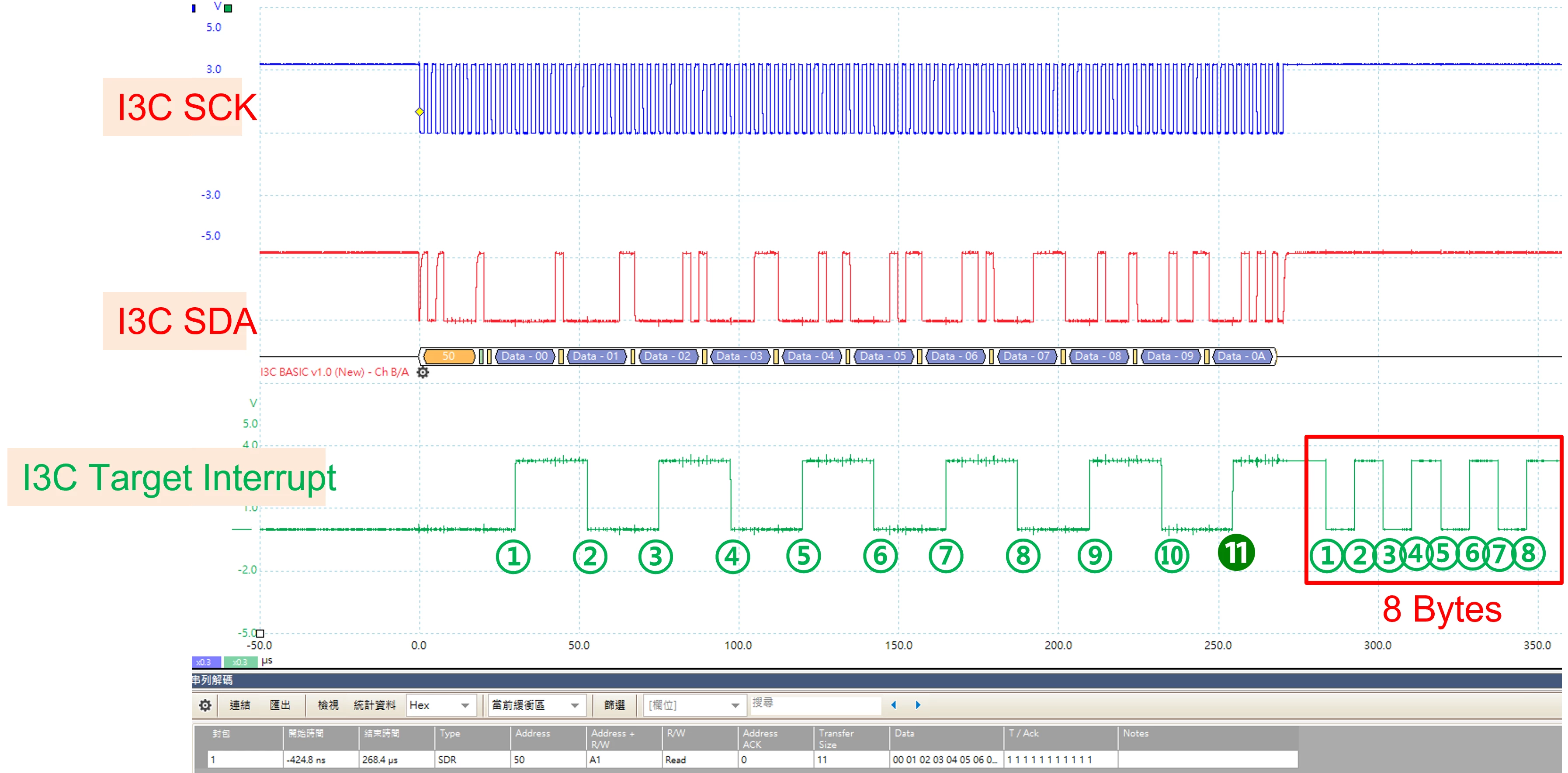

The test procedure is I3C Controller start a private read with 11 bytes and Target return the array contents.
The source code is attached, the result diagram is described below.
I3C Read TestI3C Read Test

Hello @BRIAN_LAI ,
The minimum size of TX-FIFO available when I3C Target is reading by Controller is 1 byte.
You need to indicate the status of TX FIFO preload (target mode) by using : LL_I3C_IsActiveTxPreload. Then you can Set TX FIFO Preload (target mode) LL_I3C_ConfigTxPreload

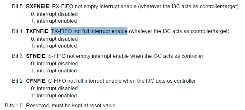

I think the root cause may be the Target Interrupt "I3C_EVR_TXFNFF" trigger when TX-FIFO is not full with 8 bytes.
Is it required to fill TX-FIFO full every time before I3C Target being read from Controller?
Are we able to implement I3C Target with using TX-FIFO only a single byte?

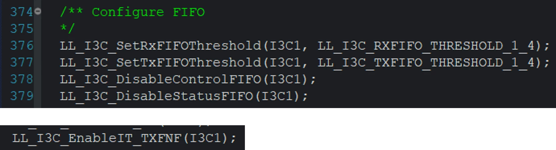

Just configure Tx Fifo Threshold : 1 byte
/** Configure FIFO**/
sFifoConfig.TxFifoThreshold =HAL_I3C_TXFIFO_THRESHOLD_1_4;
Foued

Hi @Foued_KH ,
I've already setup with "I3C_TXFIFO_THRESHOLD_1_4".
The interrupt condition is "One or more free space available in TX-FIFO". (1 byte empty then trigger Interrupt)
Is it possible to change the interrupt condition to "TX-FIFO empty" ? (only trigger Interrupt when 8 bytes empty)
