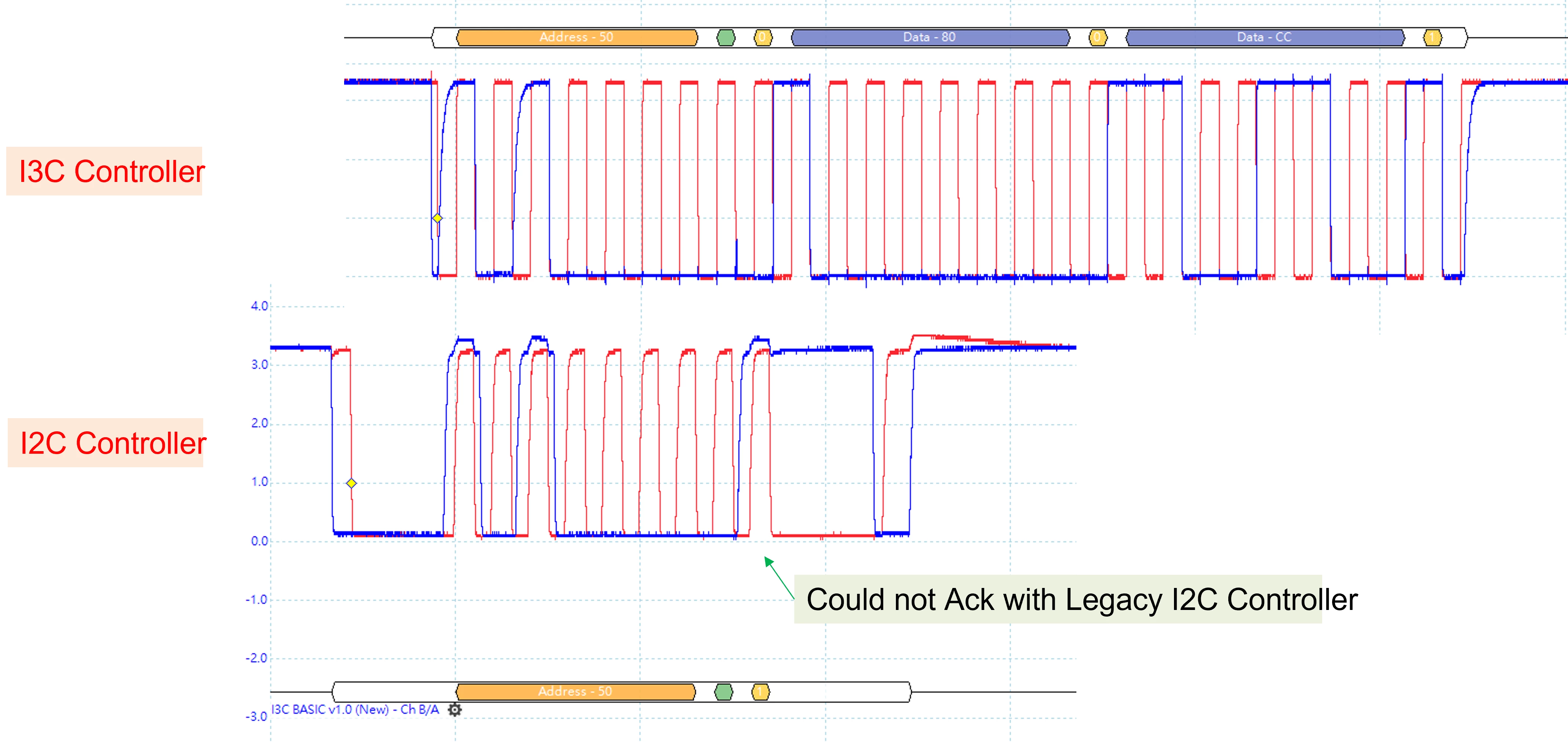

BRIAN_LAI
BRIAN_LAIAuthor
June 13, 2023
Hi @KHALSI_Foued​ ,
I have some new discover.
I found my I3C Target could ACK to the I3C Controller.
But it could not response correctly to the Legacy I2C Controller, even both of them are sending same signal:
_legacyfs_online_stmicro_images_0693W00000dDgzhQAC.pngWhy is it happening?
Is there any way to fix it?
By the way, below are my code for I3C Controller:

Foued_KH
Foued_KHBest answer
June 13, 2023
hello @BLAI.1​ ,
There is no way to communicate I2C controller with I3C target features, you can just work on I3C bus to improve the features of the I2C interface preserving some backward compatibility.
  • Legacy I2C controller is not supported in I3C bus.
