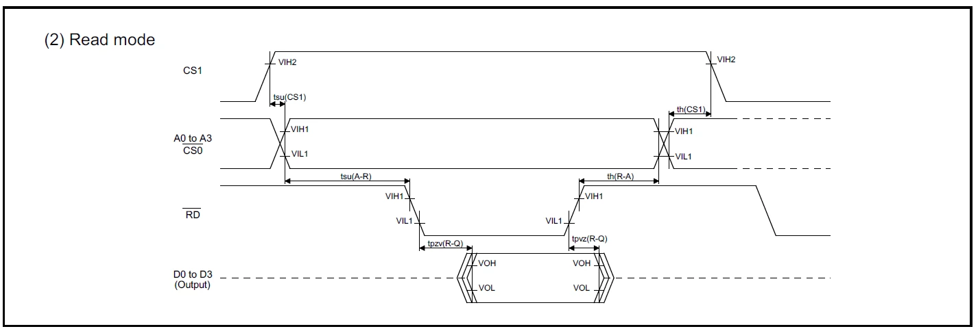

To brief about our application, we've a parallel RTC IC which has gone EOL. This RTC receives commands from the motherboard MCU. So, we're mimicking the RTC's functionality using a microcontroller and a serial RTC in a castellation PCB (smallest form factor). With the microcontroller's GPIO, we're trying to achieve parallel interface. Attached the timing diagram in this thread. Since it's a time critical application, we are preferring to go with a high speed MCU.
The flow of timing diagram goes like this...

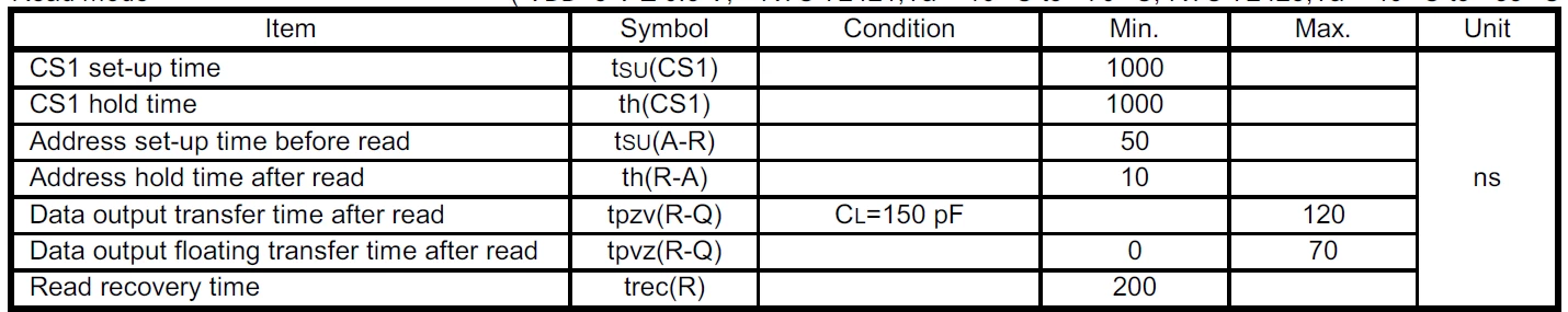

When CS0 becomes low, the address is present in the address bus (4 bit). When CS0 goes low, within min. 50ns, Read / Write pin goes low.
During read operation, the data corresponding to the address needs to be placed in data bus (4 bits of data) within 120ns max. During write operation, the data needs to be read from the data bus within 90ns.

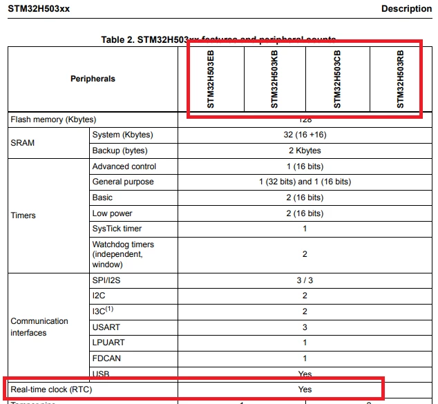

Second, and regarding your last question, this information is available in the STM32H503 datasheet / table 2 :

Hi...
Thank you for your response. Apologies for not attaching the timing diagram in the thread.
Attaching in this thread for further proceedings...

Ok thank you. But since STM32H503 device features already an RTC, why do you need to connect an external RTC then?

Hi...
Regarding the internal RTC, we are clear with the response.
We would like to know whether the timing mentioned in the timing diagram be met by the MCU - STM32H503.
Also, we would like to know what's the minimum instruction time when the clock is 250 MHz (internal source need to be used based on the size constraint).

June 18, 2024
For the first question: to confirm the timings you need to run some tests on your HW..  Not obvious to answer by yes or no.
For the second question, to my knowledge, ARM does not give the cycle count for CM33 like for CM3/CM4. See also this thread: https://community.st.com/t5/stm32-mcus-products/cortex-m33-instruction-cycle-counts/td-p/123198
Maybe you need to instrument your code to measure the instructions cycle count using DWT module:
https://developer.arm.com/documentation/100230/0004/debug-and-trace-components/data-watchpoint-and-trace-unit/dwt-functional-description
