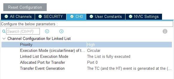

Feb 23, 2024 4:21 PM UTC
hi, i just had a similar problem and i managed to get something togather.
its reading the temperature sensor and the adc vref with the GPDMA in circular mode.
it seems that cube MX is not generating the node init at all on the H503 and on the H563 it is missing the  "LL_DMA_ConfigLinkUpdate"

 ADC_REG_InitStruct.DMATransfer = LL_ADC_REG_DMA_TRANSFER_UNLIMITED;
 /* USER CODE END ADC1_Init 1 */

static void MX_GPDMA1_Init(void)
 /* USER CODE BEGIN GPDMA1_Init 0 */
	LL_DMA_InitNodeTypeDef NodeConfig = {0};
	LL_DMA_LinkNodeTypeDef Node_GPDMA1_Channel0 = {0};
 /* USER CODE END GPDMA1_Init 0 */
 LL_DMA_InitLinkedListTypeDef DMA_InitLinkedListStruct = {0};
 /* Peripheral clock enable */
 LL_AHB1_GRP1_EnableClock(LL_AHB1_GRP1_PERIPH_GPDMA1);
 /* USER CODE BEGIN GPDMA1_Init 1 */
 /* GPDMA1_REQUEST_ADC1 Init */
	NodeConfig.SrcAddress = (uint32_t)&ADC1->DR;
	NodeConfig.DestAddress = (uint32_t)&ADC_DMA_buff[0];
	NodeConfig.BlkDataLength = sizeof(ADC_DMA_buff);
	NodeConfig.DestAllocatedPort = LL_DMA_DEST_ALLOCATED_PORT1;
	NodeConfig.DestHWordExchange = LL_DMA_DEST_HALFWORD_PRESERVE;
	NodeConfig.DestByteExchange = LL_DMA_DEST_BYTE_PRESERVE;
	NodeConfig.DestBurstLength = 1;
	NodeConfig.DestIncMode = LL_DMA_DEST_INCREMENT;
	NodeConfig.DestDataWidth = LL_DMA_DEST_DATAWIDTH_HALFWORD;
	NodeConfig.SrcAllocatedPort = LL_DMA_SRC_ALLOCATED_PORT0;
	NodeConfig.SrcByteExchange = LL_DMA_SRC_BYTE_PRESERVE;
	NodeConfig.DataAlignment = LL_DMA_DATA_ALIGN_ZEROPADD;
	NodeConfig.SrcBurstLength = 1;
	NodeConfig.SrcIncMode = LL_DMA_SRC_FIXED;
	NodeConfig.SrcDataWidth = LL_DMA_SRC_DATAWIDTH_HALFWORD;
	NodeConfig.TransferEventMode = LL_DMA_TCEM_BLK_TRANSFER;
	NodeConfig.Mode = LL_DMA_NORMAL;
	NodeConfig.BlkRptCount = 1;
	NodeConfig.TriggerPolarity = LL_DMA_TRIG_POLARITY_MASKED;
	NodeConfig.BlkHWRequest = LL_DMA_HWREQUEST_SINGLEBURST;
	NodeConfig.Direction = LL_DMA_DIRECTION_PERIPH_TO_MEMORY;
	NodeConfig.Request = LL_GPDMA1_REQUEST_ADC1;
	NodeConfig.UpdateRegisters = (LL_DMA_UPDATE_CTR1 | LL_DMA_UPDATE_CTR2 | LL_DMA_UPDATE_CBR1 | LL_DMA_UPDATE_CSAR | LL_DMA_UPDATE_CDAR | LL_DMA_UPDATE_CTR3 | LL_DMA_UPDATE_CBR2 | LL_DMA_UPDATE_CLLR);
	NodeConfig.NodeType = LL_DMA_GPDMA_LINEAR_NODE;
	LL_DMA_CreateLinkNode(&NodeConfig, &Node_GPDMA1_Channel0);
	LL_DMA_ConnectLinkNode(&Node_GPDMA1_Channel0, LL_DMA_CLLR_OFFSET5, &Node_GPDMA1_Channel0, LL_DMA_CLLR_OFFSET5);
	LL_DMA_SetLinkedListBaseAddr(GPDMA1, LL_DMA_CHANNEL_0, (uint32_t)&Node_GPDMA1_Channel0);
	LL_DMA_ConfigLinkUpdate(GPDMA1, LL_DMA_CHANNEL_0, (LL_DMA_UPDATE_CTR1 | LL_DMA_UPDATE_CTR2 | LL_DMA_UPDATE_CBR1 | LL_DMA_UPDATE_CSAR | LL_DMA_UPDATE_CDAR | LL_DMA_UPDATE_CTR3 | LL_DMA_UPDATE_CBR2 | LL_DMA_UPDATE_CLLR),(uint32_t)&Node_GPDMA1_Channel0);
 /* USER CODE END GPDMA1_Init 1 */
 DMA_InitLinkedListStruct.Priority = LL_DMA_LOW_PRIORITY_HIGH_WEIGHT;
 DMA_InitLinkedListStruct.LinkStepMode = LL_DMA_LSM_FULL_EXECUTION;
 DMA_InitLinkedListStruct.LinkAllocatedPort = LL_DMA_LINK_ALLOCATED_PORT0;
 DMA_InitLinkedListStruct.TransferEventMode = LL_DMA_TCEM_LAST_LLITEM_TRANSFER;
 LL_DMA_List_Init(GPDMA1, LL_DMA_CHANNEL_0, &DMA_InitLinkedListStruct);
 /* USER CODE BEGIN GPDMA1_Init 2 */

this code is working here in cubeIDE on the nucleo STM32H503 board. the raw temperature sensor and vref values can be seen in  ADC_DMA_buff
Feb 26, 2024 8:45 AM UTC
Thank you @nix for sharing you project
Could you please share an .ioc file that reproduces the issue from CubeMX side?
Thank you!
Visitor II
Feb 26, 2024 11:14 AM UTC
hi, the H503_TEST.ioc file is in the above attached H503_TEST.rar file.
to complete the list of problems that occur (for me) with that adc to dma stuff:
  1. in the ADC1 tab, i set the dma continuous request to enabled, but:
    is not generated, without it dont seems to request the DMA
  2. with the H503KBUx selected, i can configure almost nothing in the GPDMA tabs
    so it only generates the DMA_InitLinkedListStruct.
    (with the H563) it it does generate the nodeconfig and the Node_GPDMA1_Channel0 init.
  3. on both (H503 and H563) the LL_DMA_ConfigLinkUpdate is missing, without the DMA starts with no init and will set the user error flag
the GPDMA node should be initialised as static.. it works in the code i posted, but in my main project where i do more then just ADC to DMA the ram gets changed and as the GPDMA reads the node continuous it must stay what it is.
i think thats it so far
