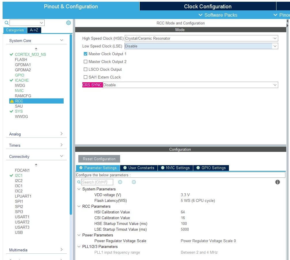

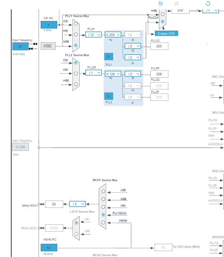

I anyone would like to reproduce it, it is very easy to reproduce.
Build a project in CubeMX for the Nucleo-h503RB board.
NOTE: You have to manually set the pin drive strength to VERY_HIGH because CubeMX will default it to LOW.
Configure the clock tree as follows:
You will get no output on MCO1 (PA8 which is pin D7 on the Arduino connector on that Nucleo board).
Now, re-test, changing the MCO1 clock source to any of the other choices and you will get the expected output.  Try changing to using different dividers and same results--no output with PLL1 but works with the others.  (I tried all the way to /15 which is the max for MCO1).
