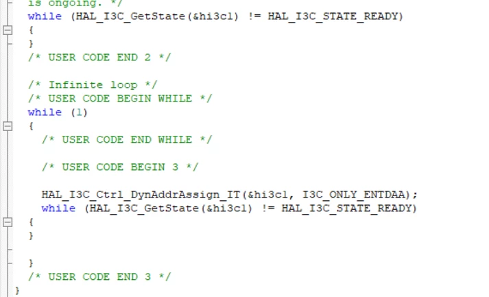

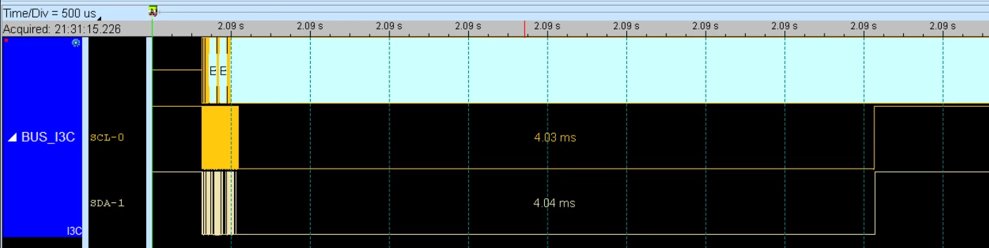

I am working off of the example I3C ENTDAA CMD for the STM32H5 series to initialize a slave device. I am stuck in a wierd phenomenon that once CCC CMD triggered and then after more than 300 mS, the I3C function is dead.
The test setting as below, The CCC  command put in a while-loop, and measured the waveforms by LA.

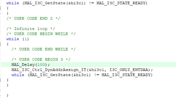

Another tricky phenomenon that there is a HAL_Delay put in the front of the I3C CCC command and the I3C SDA and SCL not launch the signals.
Is there something else that could be causing this? And how to solve the error? Thanks.

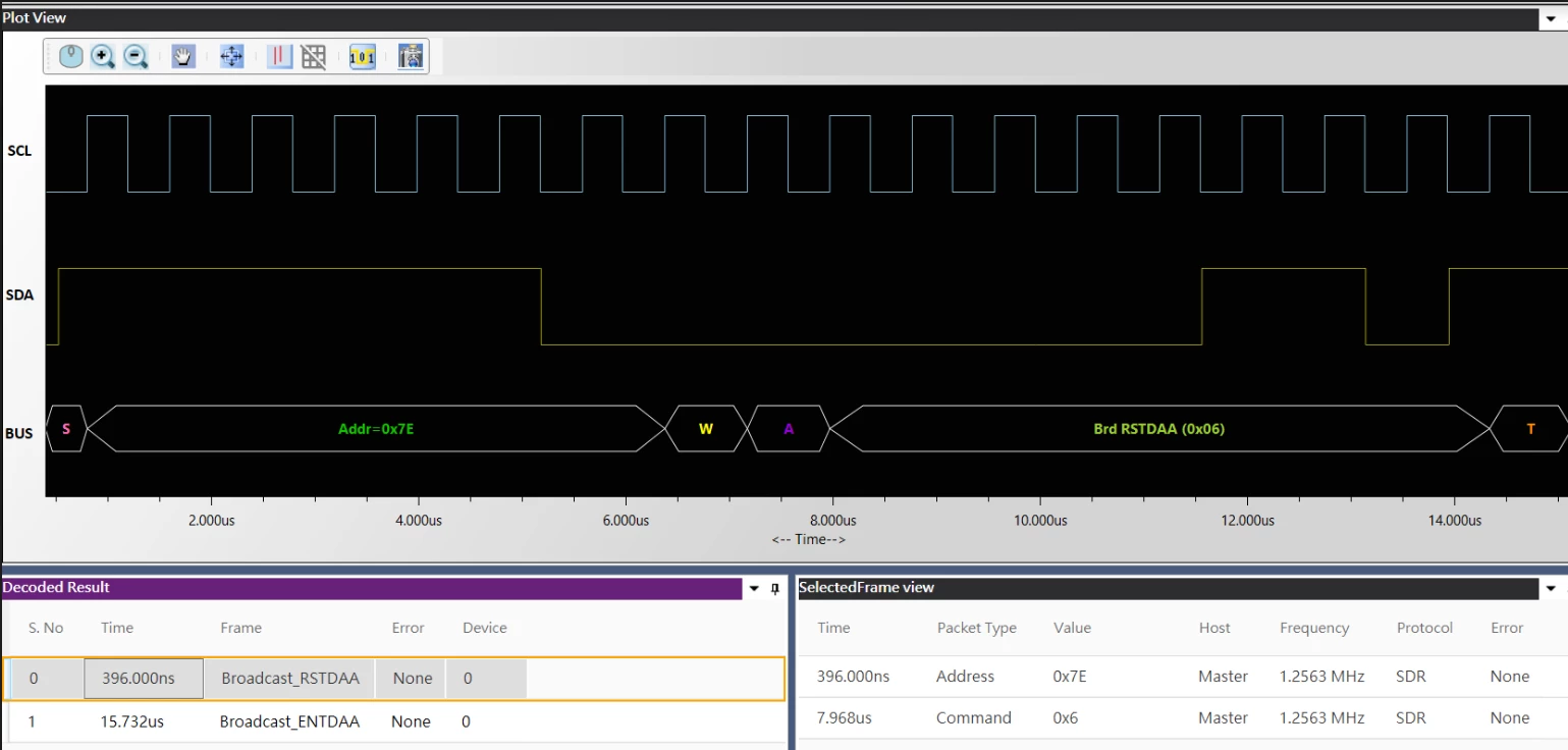

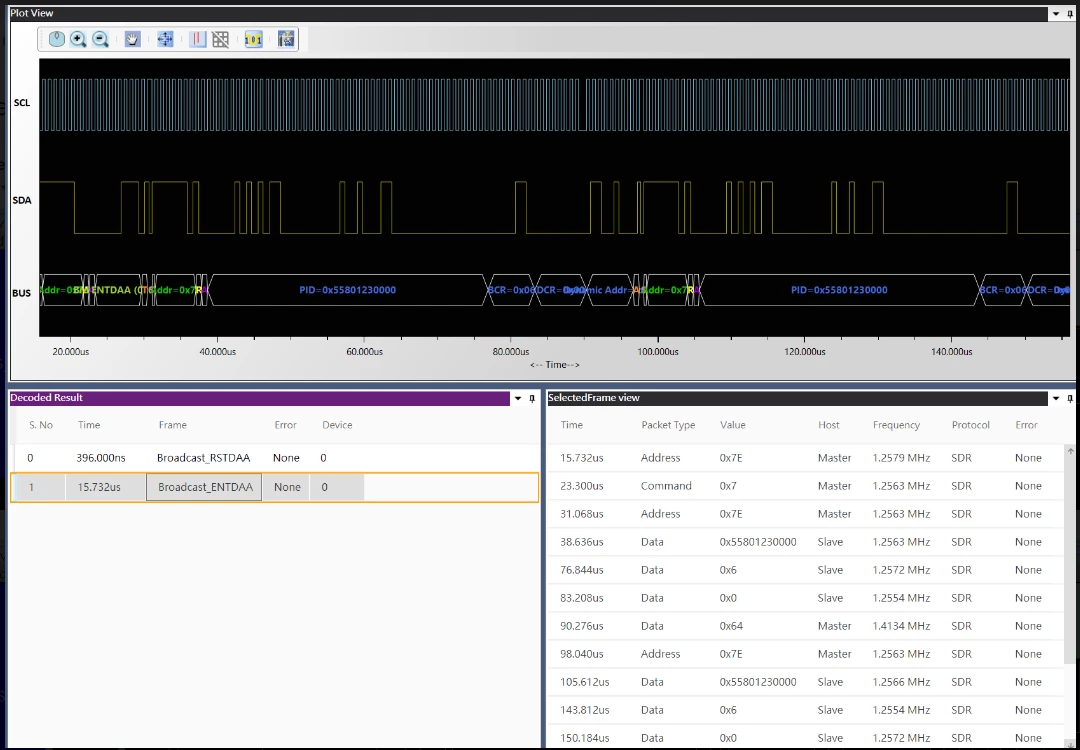

I put the I3C_RSTDAA_THEN_ENTDAA CMD iinto the while-loop, the I3C waveforms are shown as below,
The I3C_RSTDAA_THEN_ENTDAA waveform is shown at onece, then it stucks.
Foued_KH
Apr 22, 2024 2:51 PM UTC
You only need to assign only one time a dynamic address and if you want to change it you should sent RSTDAA and then ENTDAA .
Why did you put the dynamic address assignment into the while-loop ?
