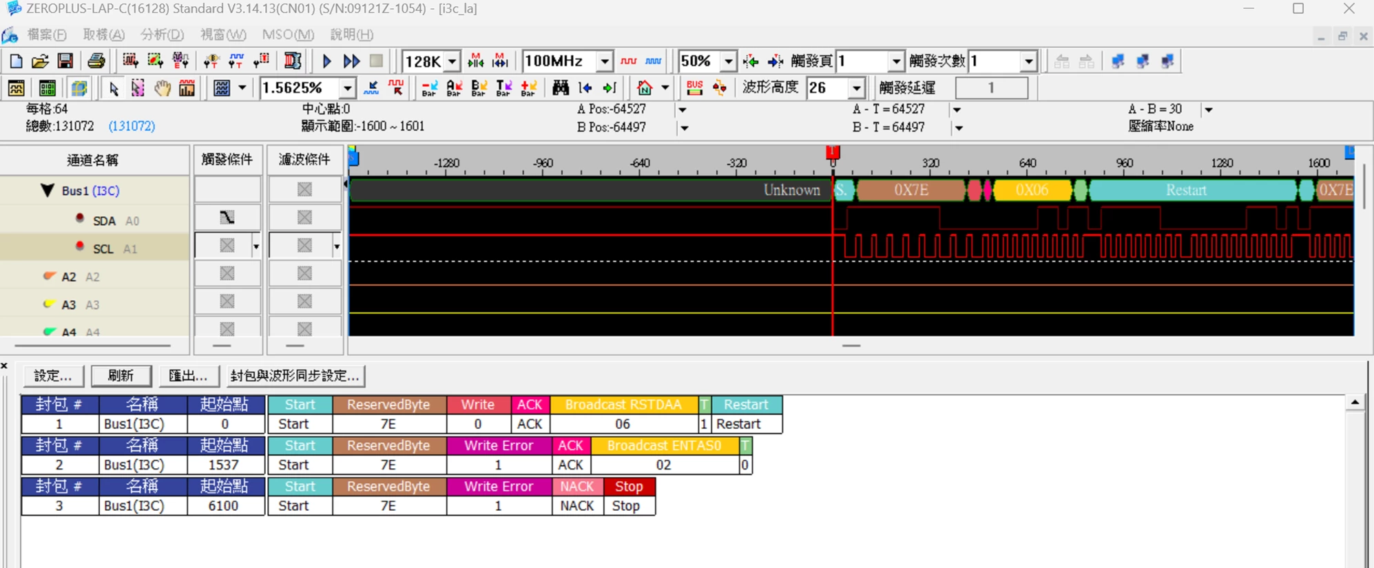

Hi, I am working with STM32H503RB.

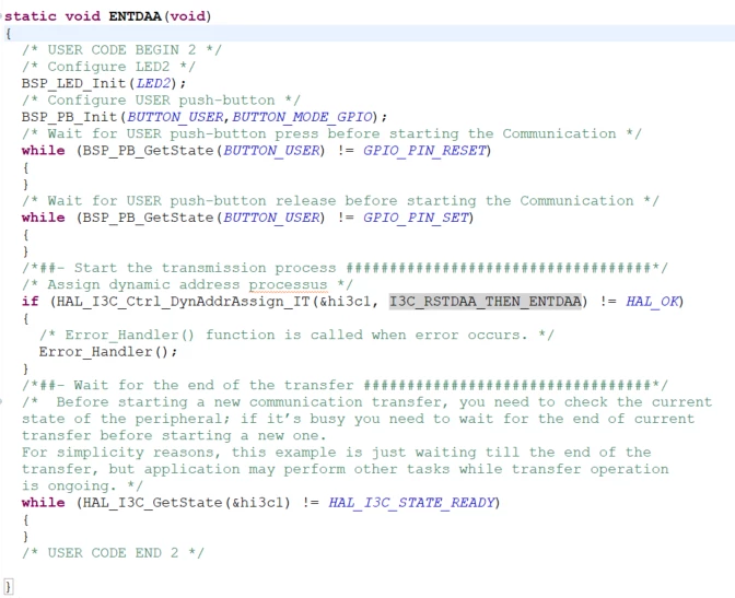

I'm currently testing the function of "I3C_Controller_ENTDAA_IT" from the example code.
Capture1 is the result of "I3C_RSTDAA_THEN_ENTDAA"
The expected behavior of Capture1 should be 7E06 then 7E07.
Why would 7E02 occur along with a write error?

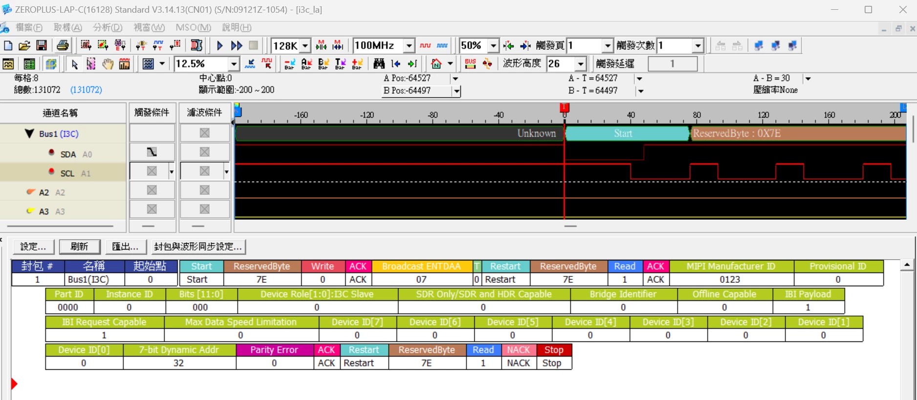

Capture2 is the result of "I3C_ONLY_ENTDAA"
My questions are:
1. I'm wondering where is the code that define the configures in color green.
2. Is it able to modify their values?
3. Is it a successful ENTDAA process?

Hello @SteveDu,
If you are using a sensor as an I3C target you can't modify these value.
But If you are connection STM32 MCU as a target you can modify the Bits 15:12 MIPIID[3:0]: 4-bit MIPI Instance ID by software.
When STM32 MCU as target :
DCR[7:0]: device characteristics ID
- 0x00: generic device (for v1.0 devices)
- others: ID to describe the type of the I3C sensor/device
Note: The latest MIPI DCR ID assignments are available on https://www.mipi.org
BCR[7:0] :  bus characteristics register
you can configure three bits used by hardware.
for more information : check the section : 35.16.23 I3C bus characteristics register (I3C_BCR) RM0492
3.Capture2 is good result of dynamic addressing.

1. Still wondering whether the waveform in Capture1 matched the expected behavior of the code below.
if (HAL_I3C_Ctrl_DynAddrAssign_IT(&hi3c1, I3C_RSTDAA_THEN_ENTDAA) != HAL_OK)
/* Error_Handler() function is called when error occurs. */
 Error_Handler();
If not, please help me to fix this problem.:folded_hands:

1/ could you please the section 4.1.1. Interrupt mode in the WIKI : Getting started with I3C - stm32mcu
