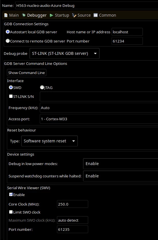

We want to use now the STM32H5 for future projects. In the past, we used STM32F4 with enabled SWO for debugging. Is there any example available to get this feature working for STM32H503? Would be great to do it on register level to be independent from IDE...

Ahh, ok. You want send some printf(..)   as debug info etc. - right ?
Thats easy ->
>with a working register configuration to get SWO running
no need - debug unit is "always ready to work" . :)
-> just put this at end of main.c (...see : user code..)
int __io_putchar(int ch)
 ITM_SendChar(ch);
 return (ch);
/* USER CODE END 4 */
Then can use printf and it will come to SWO -> console . (always with \r \n , at end ! )
printf("************** RTOS start ****************\r\n");

SWO is not different , its connection to debug unit; if you set everything in "working condition", it will work.
see my debug setting:

All the SWO configuration is hidden in this case. How can I confirm that the configuration is correct if I can't see it?
in wich case ?
In IDE i showed , what to set in debug setup. (For jlink tools - i dont know. You should ask this at Segger..)

like I already mentioned, I want to do it IDE-independent based on register access and I want to use the tool J-Link SWO Viewer. The IDEs do lot of magic stuff ;)
Unfortunately, I found no details in datasheet or reference manual.
